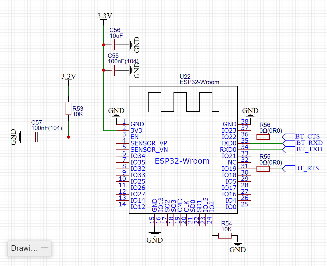

I'm trying to use a ESP32-WROOM as a bluetooth coprocessor for a raspberry pi. On the PCB there is only one UART connection between the pi host and the ESP32, on UART0, similar to the example shown here:
https://lb.raspberrypi.org/forums/viewt ... p?t=183618
The poster appears to indicate they are able to use the ESP32 as a bluetooth coprocessor. My schematic is attached, as well, it's essentially the same.
But I noticed when I bring up the menuconfig to turn on UART HCI mode, the only UARTs it will allow me to choose are UART1 or UART2. Is there any way to use the ESP32 as a bluetooth coprocessor on UART0? Maybe there's a setting in the menuconfig I need to disable the use of UART0 for something else to allow this?
If UART0 is not possible, is there any other way to use the ESP32 from the raspberry pi over UART0?
UART HCI Mode with UART0
Re: UART HCI Mode with UART0
Not sure if there are ways to get it working over UART0, but the ESP32 has a GPIO matrix that you can use to re-map IO pins. You could route UART0 to some spare pins (or disconnect it entirely), then route UART2 or 3 to the previously used pins.
Tried this, still having no luck. I'm not sure whether the issue is my ESP32 logic to change the pins or the setup on my host controller. In any case I was able to successfully flash the ESP32 over UART0, I used a modified version of the controller_hci_uart example. I used the following code to attempt to remap UART1 to the UART0 pins. Seems pretty straightforward, but since it's not working I wonder if I'm missing something.
Found the issue. RTS/CTS were reversed and the host controller settings weren't quite right. All is working now, thanks for your help
