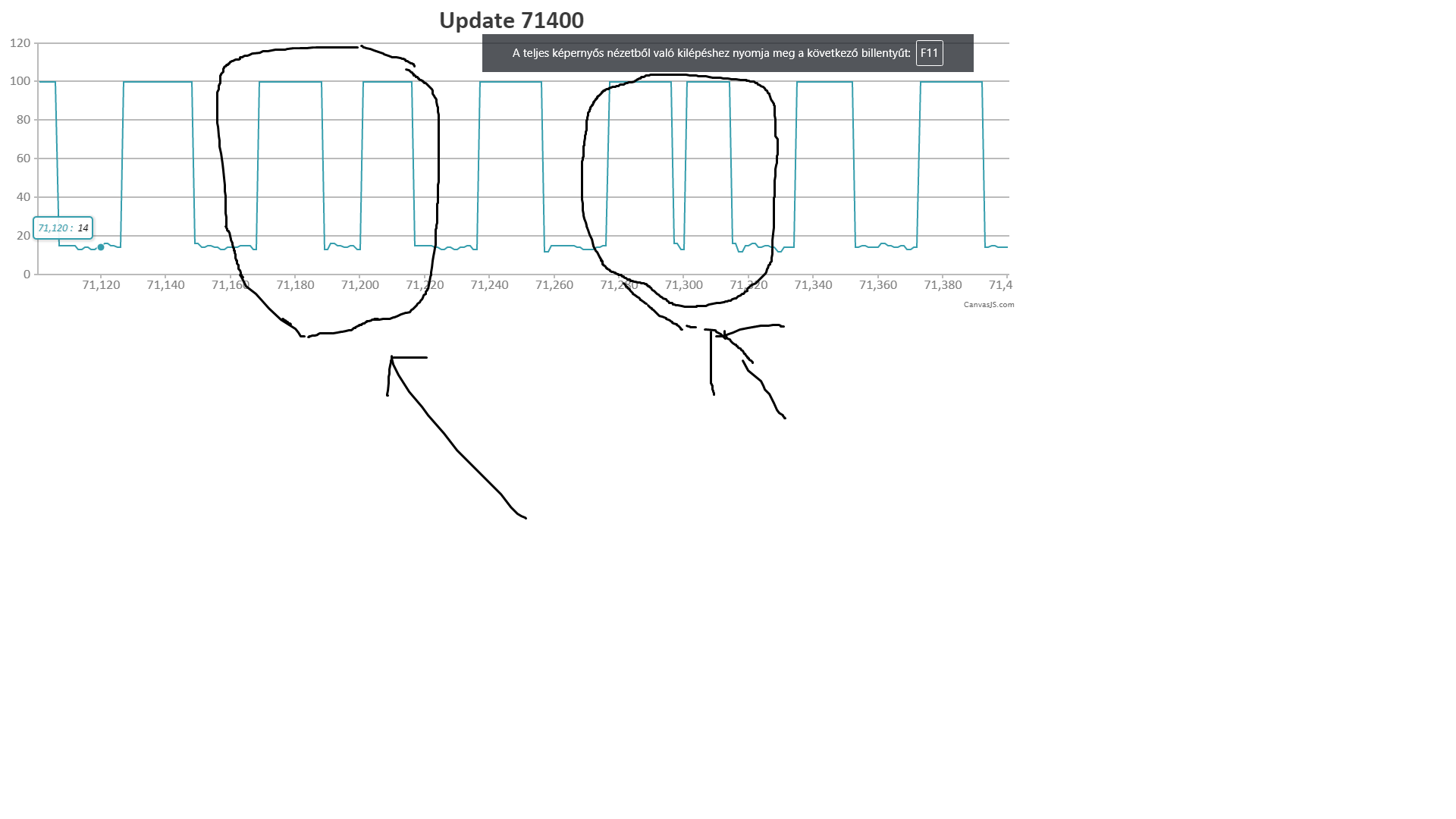

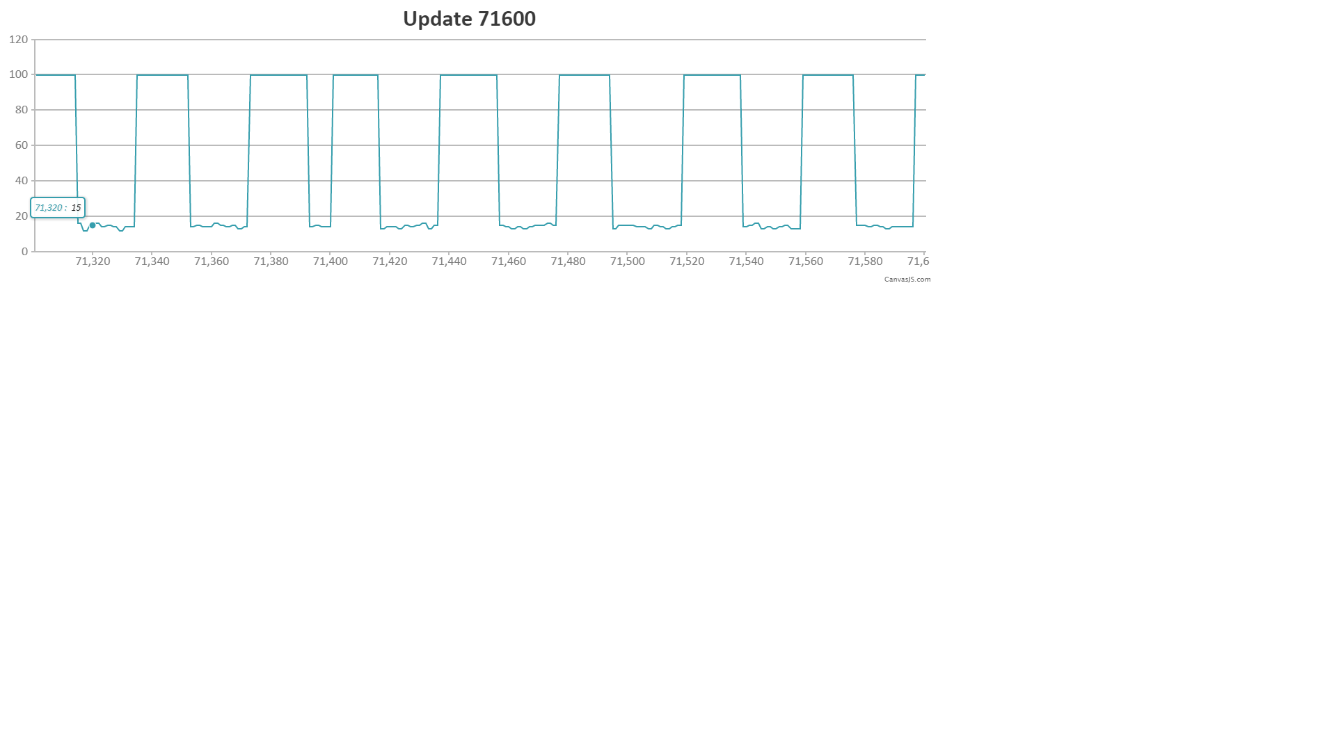

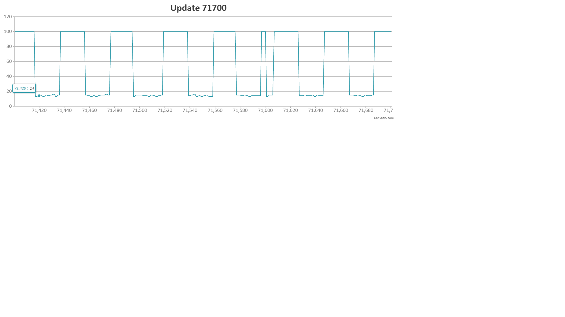

My i2s dma buffer is overflowing and i can see it in the visualized data.
What i think is happening:
-While i read the entire DMA buffer, the i2s adc is filling up this buffer again and again even if i doesn't end up reading from the entire buffer. This will result on buffer overflow and my readed data does not mach the actual reading.
What i think is the solution:
-If there will be an interrupt on the i2s adc dma, if it is filled up the entire buffer i would switch to an other buffer while i read the first, and when i done with the reading i would read from the second while the adc filling up the first and so on...
The thing is i did not find anything from this interrupt on the Arduino core. The one thing that i found is an event solution, that i think is just a flag and does not work as expected.
So my question is, how can i avoid this buffer overflow or how can i assign an interrupt to the dma buffer, or how can it be done correctly.

I attached some pictures from the readed data on the web.
Képernyőfelvétel (23).png (30.67 KiB) Viewed 9427 times
Képernyőfelvétel (22).png (31.2 KiB) Viewed 9427 times
Képernyőfelvétel (21).png (53.88 KiB) Viewed 9427 times

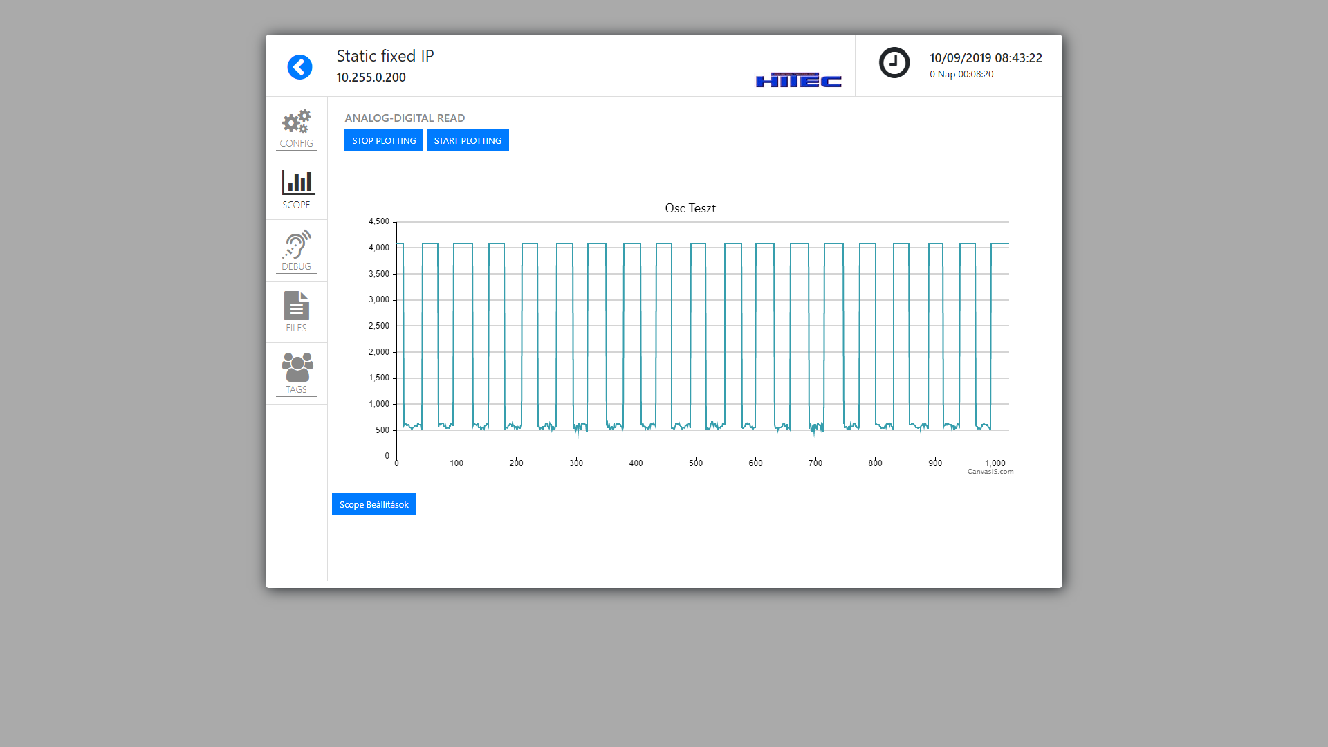

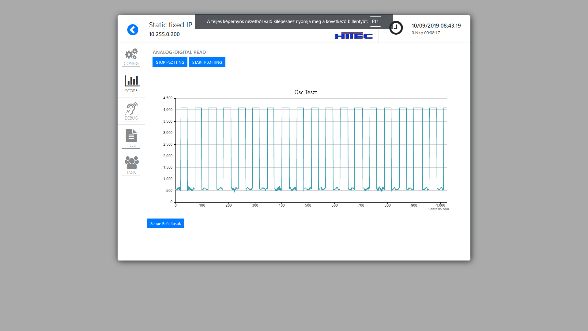

My problem is partially solved.
The solution was that i had to separate my i2s reading and plotting function and put them on the two cores.
Now my i2s reading function on core 1 is looks like this:

I attached some pictures from the visualized data on the web.
Képernyőfelvétel (27).png (73.11 KiB) Viewed 9316 times
Képernyőfelvétel (26).png (78.74 KiB) Viewed 9316 times
