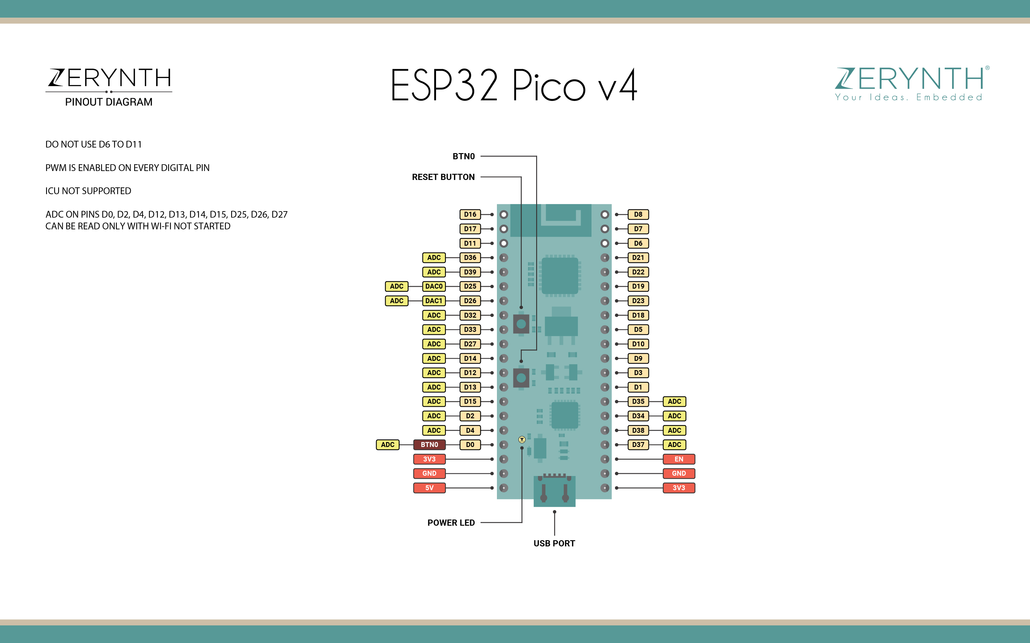

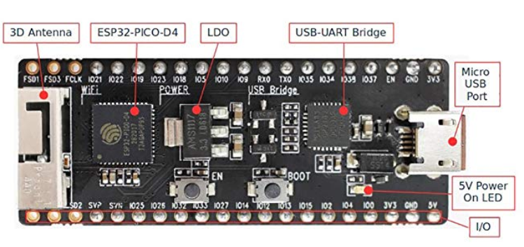

Where is the 7-12V input pin?
What if I have a buck converter that steps down the voltage to 3.3V, where do I plug it in? The 3V3 pin?

- ESP32-PICO-KIT V4.1 top view.PNG (469.41 KiB) Viewed 5437 times
- esp32_pico_v4_pin_io.jpg (665.5 KiB) Viewed 5440 times

There is no 7-12V input. The 5V input is connected to the USB->UART adapter (CP2012), so applying >5V will burn that chip. Use 3V3 on the 3V3 pin, or 5V on the 5V pin.

Got it thanks.
It wasn't clear if those 3v3 or 5v pins were just outputs or could be also used as inputs.
I will use them as both using this buck converter:
