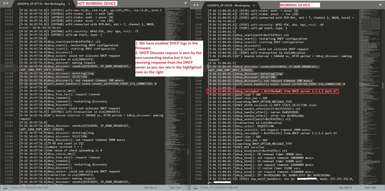

Hi, we are also facing the same issue but for us some of the devices are getting IP and some aren't.
- In the router - MAC id whitelisting is done correctly, we have checked free ips are available.
- Enabled DHCP logs, discover request is being sent from the devices but not all of them is receiving response from DHCP server (router)
dhcp logs.jpg (371.96 KiB) Viewed 28809 times
CONFIG_LWIP_DHCP_DOES_ARP_CHECK isn't enabled. Any ideas on how to resolve this.
Thanks in advance for your help.
