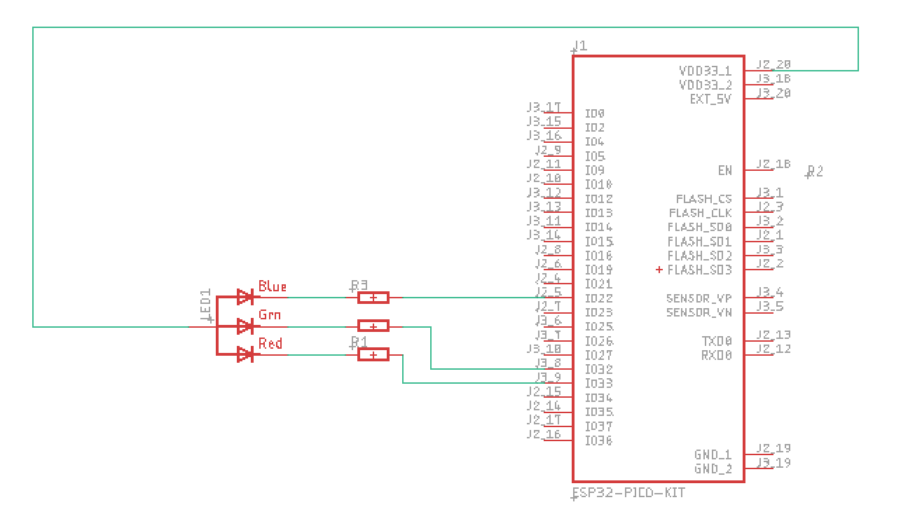

This is the circuit I'm using:
Screenshot 2020-01-14 at 22.20.50.png (54.94 KiB) Viewed 5674 times

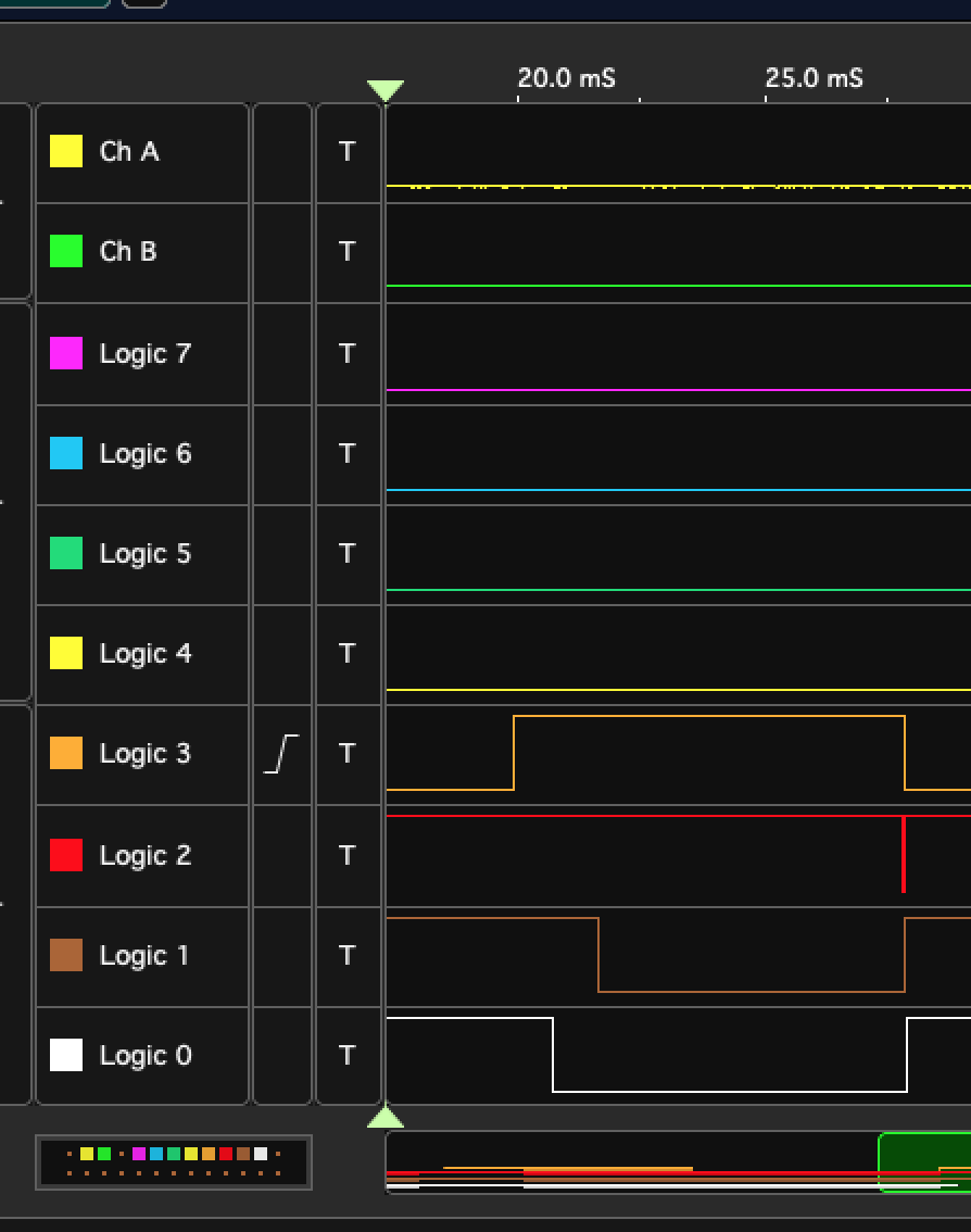

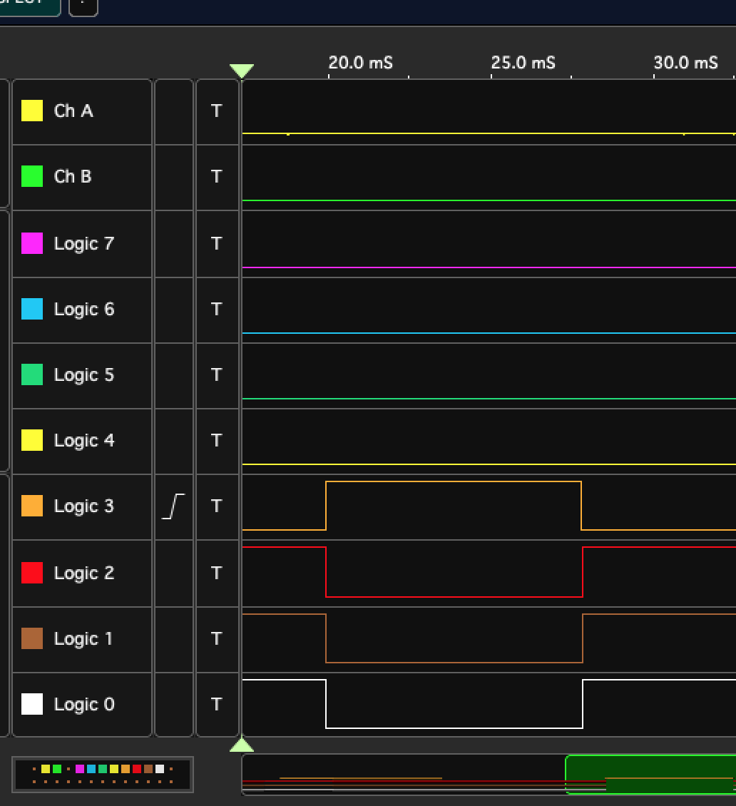

I see that all three outputs ( Logic 0-2) go low for ~8ms after a ESP.deepSleep(2000);:
Screenshot 2020-01-14 at 22.26.04.png (63.94 KiB) Viewed 5674 times
Also after a ESP.restart(); the outputs go low put at different times and for different lenghts:
Screenshot 2020-01-14 at 22.29.45.png (59.78 KiB) Viewed 5674 times
