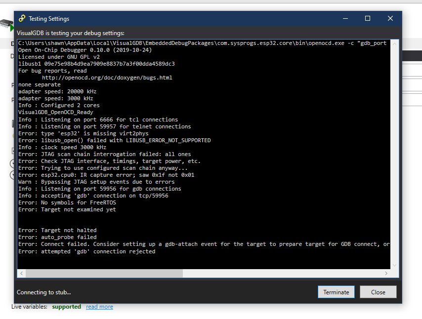

Debugging DevKitv3 with Visual GDB
Postby kurtnelle » Thu Feb 13, 2020 9:24 pm
Annotation 2020-02-13 014504.png (70.42 KiB) Viewed 9346 times
I have version 3 of the wrover dev kit. I need to set it up so that I can debug using Visual GDB, but I get this error output (see attached) when I test the connection. Visual GDB support says that it's a problem in how the device is setup/connected. How do I setup the jumpers so that Visual GDB will test successfull?

Another thing that comes to mind: what program is loaded into the ESP32? If this program redefines GPIO12-15 to do something else, JTAG won't work, and you'd get a similar error to what's in your screenshot.

Postby kurtnelle » Mon Feb 17, 2020 4:41 pm
" If this program redefines GPIO12-15 to do something else, JTAG won't work" -- that makes some sense. I will invoke esptool.py to erase the flash and try again. Who knows?!

Postby kurtnelle » Mon Feb 17, 2020 11:37 pm
I erased the program. Same problem. Problem persists. Same screenshot. Same error message.

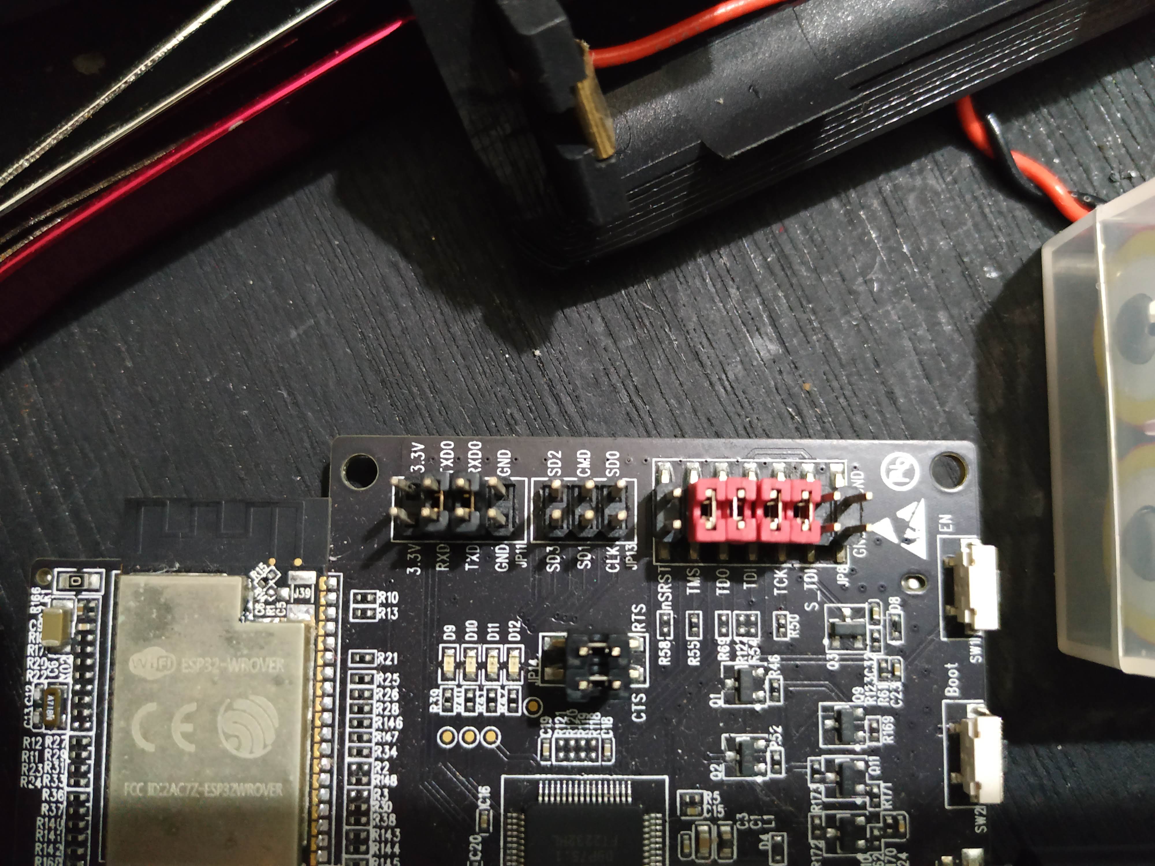

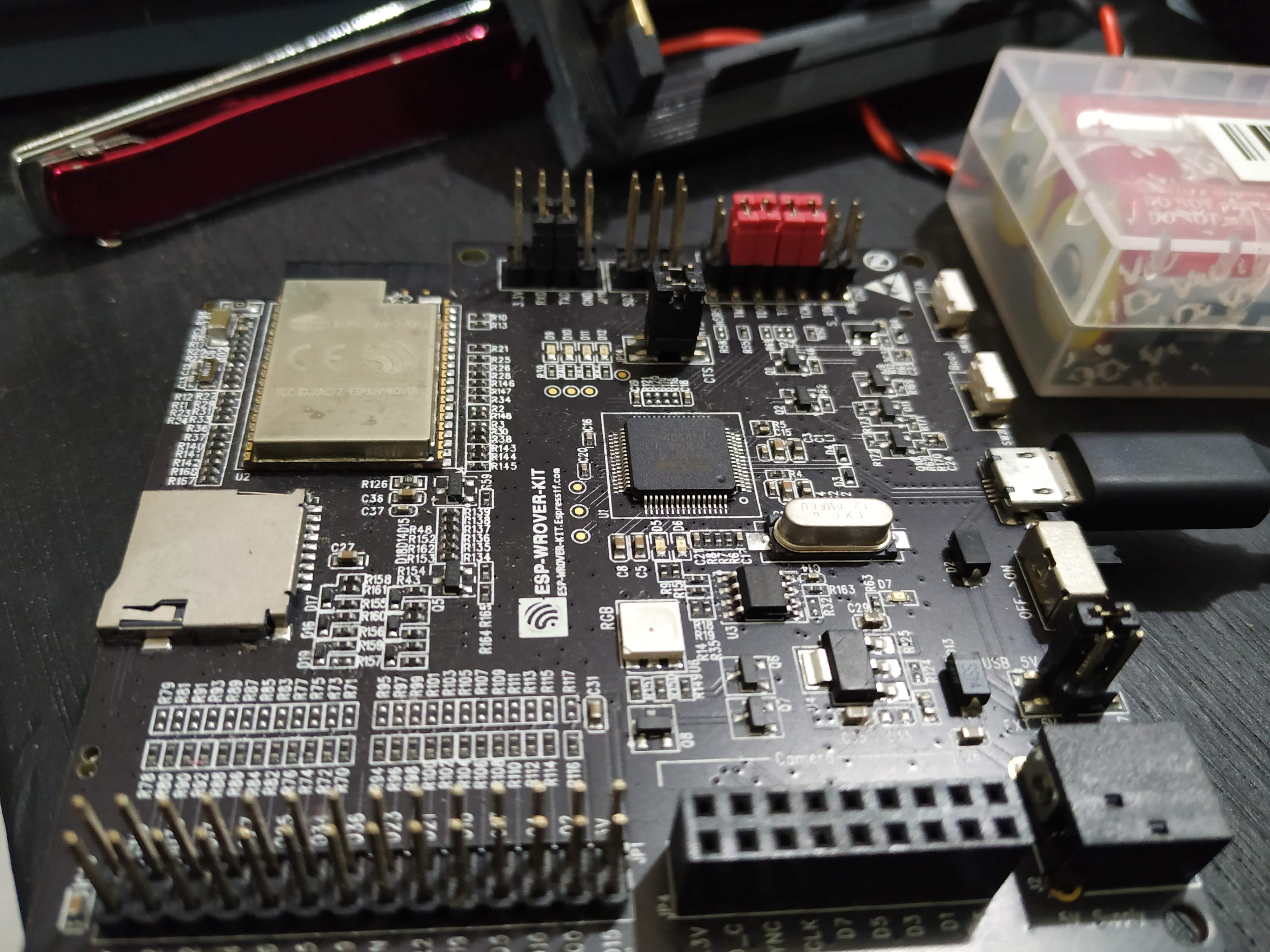

Postby Sprite » Tue Feb 18, 2020 8:26 am
Just so we can double-check: any chance you can post a picture of the jumpers on your board? Also, you're sure you don't have anything else attached to the PC that openocd can see as a second jtag adapter?

Postby kurtnelle » Wed Feb 19, 2020 1:11 am
Jumpers Ahoy!
