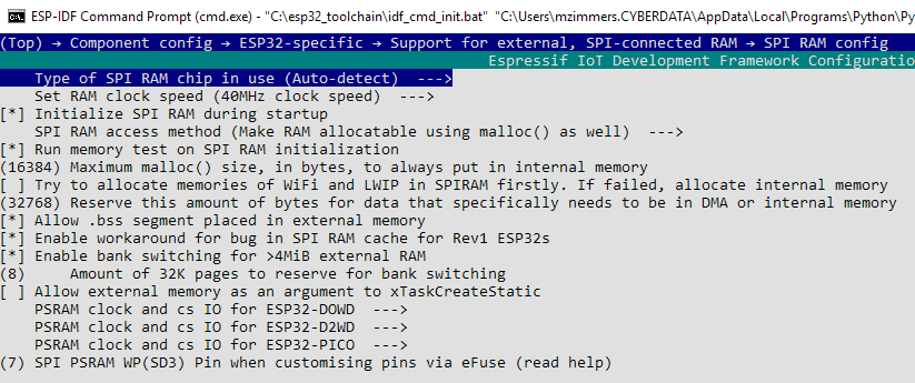

Hi Angus - we may be getting somewhere on this. When I begin starting tasks, I have ~152KB of MALLOC_CAP_8BIT | MALLOC_CAP_INTERNAL RAM. Each task I start consumes about 8K (seems reasonable to me). As I have several tasks, the number is reduced to about 64K.
Then, my Wifi initialization runs. The big hit seems to occur when I call esp_wifi_init():
memReport("after step #1.3 in taskInit()");
    // step 1.4 in https://docs.espressif.com/projects/esp-idf/en/latest/api-guides/wifi.html
    wifi_init_config_t wifiInitConfig;
    wifiInitConfig = WIFI_INIT_CONFIG_DEFAULT();
    err = esp_wifi_init(&wifiInitConfig);
    if (err != ESP_OK)
        ESP_LOGE(TAG, "taskInit(): esp_wifi_init() returned 0x%x; halting task.", err);
        vTaskDelay(portMAX_DELAY);
vTaskDelay(100);
memReport("after step #1.4 in taskInit()");
Here's the results:

So it appears that esp_wifi_init() is using a little over 50KB of internal RAM. What's left isn't enough to run the app, so I get aborts in various places, depending on my exact settings, currently set thus:
                                         Espressif IoT Development Framework Configuration
    Type of SPI RAM chip in use (Auto-detect)  --->
    Set RAM clock speed (40MHz clock speed)  --->
[*] Initialize SPI RAM during startup
    SPI RAM access method (Make RAM allocatable using heap_caps_malloc(..., MALLOC_CAP_SPIRAM))  --->
[*] Run memory test on SPI RAM initialization
[*] Try to allocate memories of WiFi and LWIP in SPIRAM firstly. If failed, allocate internal memory
[*] Allow .bss segment placed in external memory
[*] Enable workaround for bug in SPI RAM cache for Rev1 ESP32s
[*] Enable bank switching for >4MiB external RAM
(8)     Amount of 32K pages to reserve for bank switching
    PSRAM clock and cs IO for ESP32-DOWD  --->
    PSRAM clock and cs IO for ESP32-D2WD  --->
    PSRAM clock and cs IO for ESP32-PICO  --->
(7) SPI PSRAM WP(SD3) Pin when customising pins via eFuse (read help)
Does this seem "correct" to you? 50K seems like a lot, but if this is what it takes, I guess I need to somehow use less in other areas.
PeterR
Posts: 621
Joined: Mon Jun 04, 2018 2:47 pm
Re: "unexpected spi flash error code:101"
Postby PeterR » Wed Feb 19, 2020 6:37 pm
Yes, 50K is about right for the initialisation call. You can reduce the number of 'static' buffers in menuconfig.
I would be interested in ESP's answers though.
If you read menuconfig Wifi buffer's help then there are both static & dynamic buffers. As I read it your init has allocated some static buffers. The help suggest that you must also have dynamic buffers (why?). Might more heap disappear under high loading?
PS You also loose quite a lot of to Wifi memory as .bss and .data sections.
PPS 8KB stack size is a lot, unless you are using printf() etc. Try uxTaskGetSystemState() after running for a bit and reduce as needed.
Also, starting with 152KB seems wrong. You should be able to start at 200KB (ish) with Wifi. Did you forget to put const in front of some initialisation data? A lot of Linux/PC code will fail to do that.
If you have PSRAM then you can push some .bss and Wifi out. Not sure what the performance hit is.
& I also believe that IDF CAN should be fixed.
