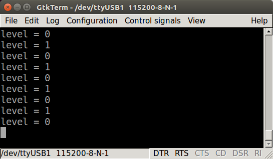

And to make sure it's not a device connectivity issue, I used GtkTerm to make sure I can see the device output (I added a printf to the blink example project), and it worked just fine.
sameer@testWROVER:/opt/gnuarmeclipse/openocd-esp32$ gtkterm -p /dev/ttyUSB1 -s 115200
Am I missing something?

Ok ... it took some time, but I figured it out.
I was having problems due to three distinct issues
A) I didn't realize that OpenOCD needed the D2XX FTDI API
B) D2XX as a user-space API conflicts with the kernel-space driver that my Linux OS automatically loads upon connecting the WROVER-KIT, so I had to follow the instructions given in this readme by FTDI regarding unloading the driver. Specifically:
If "ftdi_sio" is listed:
        Unload it (and its helper module, usbserial), as follows.
        sudo rmmod ftdi_sio
        sudo rmmod usbserial
I had to unload those two drivers every time I connected the WROVER-KIT.
C) I am using an LXC container, which did not have access to the device (it only had access to the serial files ttyUSB0 and ttyUSB1, which is why I was able to use GtkTerm with no issues). I used this guide to fix this problem.
