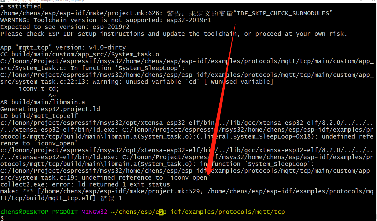

想要实现编码转换,然而编译错误 undefined reference to `iconv_open'
chenqing_lang
Joined: Fri Mar 27, 2020 8:45 am
Postby chenqing_lang » Fri Mar 27, 2020 8:51 am
编译结果
我自己代码中已经写好#include <iconv.h>的了
#include "include.h"
#include <iconv.h>
extern struct demoksApi demoks;
void System_SleepLoop(void)
    unsigned char key;
    char string[32];
    Gpio_init();
    OLED_Init();
    OLED_DispStr16(0,0,"Startup..",0);
    OLED_DispStr16(0,2,"启动..",0);
    printf("启动..\r\n");
    iconv_t cd;
    iconv_open("gb2312","utf-8");
    printf("iconv_open()\r\n");

Re: 想要实现编码转换,然而编译错误 undefined reference to `iconv_open'
Postby Gargamel » Sat Mar 28, 2020 1:02 pm
esp-idf 中没有对 iconv 的支持,需要自行移植如 libiconv。
