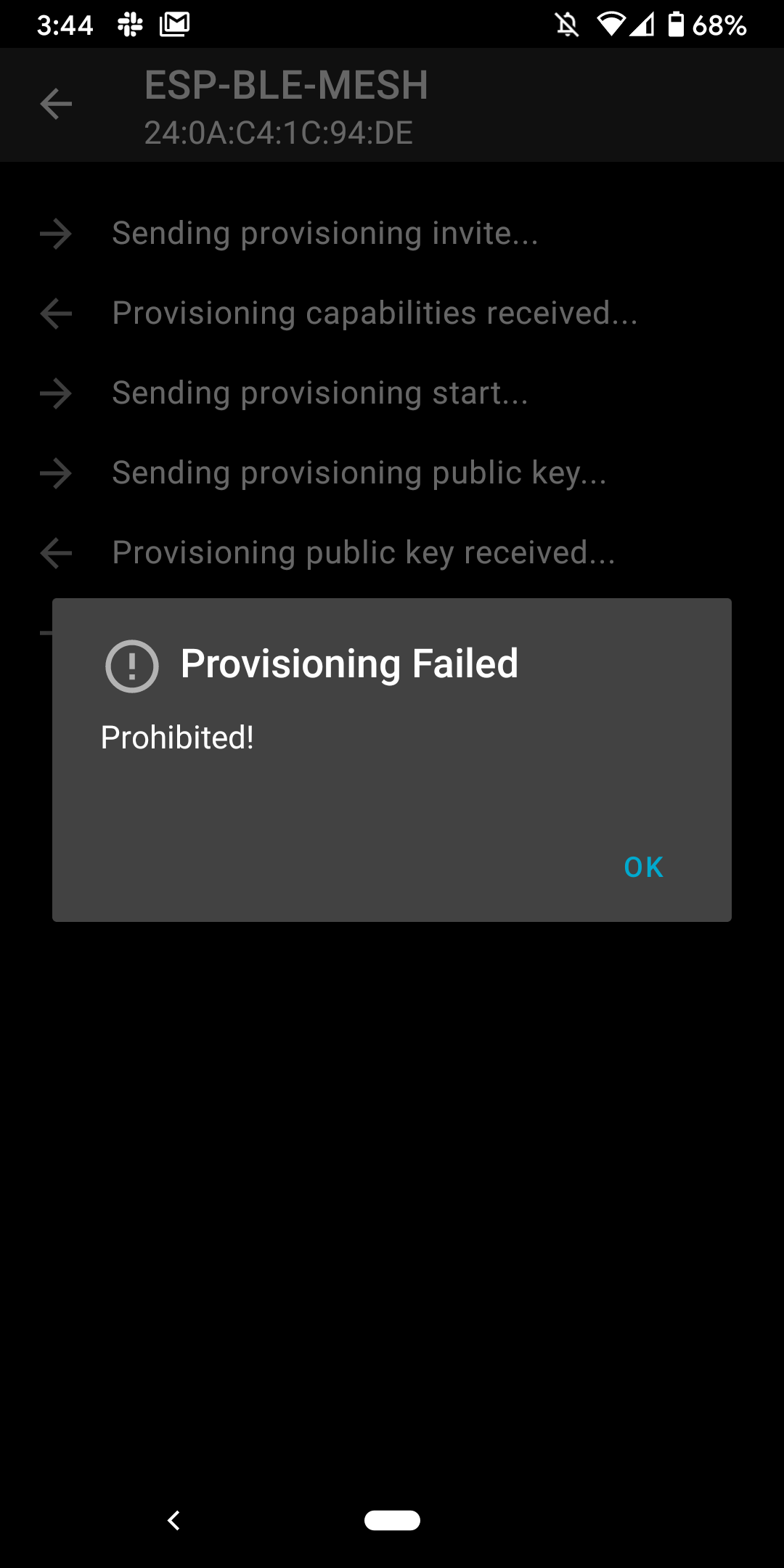

Device: ESP32-WROOM-32D
SDK: 4.01
Example Instructions URL: https://docs.espressif.com/projects/esp ... index.html
I am following the instructions and everything is working fine except provisioning. The android nrf-mesh app returns:
"Provisioning Failed, Prohibited" (see attached image). I have tried the Cypress mesh app, and ST mesh app and they also fail as well. The ST mesh app appears to complete, but when I attempt to examine an element the app crashes.
Any assistance with this would be appreciated.
To follow is the monitor when I attempt to provision with nrf-mesh

iamkkk
Posts: 7
Joined: Thu Apr 16, 2020 2:34 am
Re: ESP32 BLE mesh example fails to provision
Postby iamkkk » Mon Jun 01, 2020 11:14 am
It seems nRF APK detect Provsionee public key X, Y is invalidate
in ECPoint ecPoint = curve.validatePoint(x, y); and nRF APK call exception
I use bt_mesh_check_public_key to check Provsionee 's bt_mesh_public_key and bt_mesh_check_public_key also show fail.
It seem esp mesh profile generate wrong bt_mesh_public_key.
Hi iamkkk,
This issue has been updated in the esp-idf Github Issues, please refer to https://github.com/espressif/esp-idf/issues/5341
