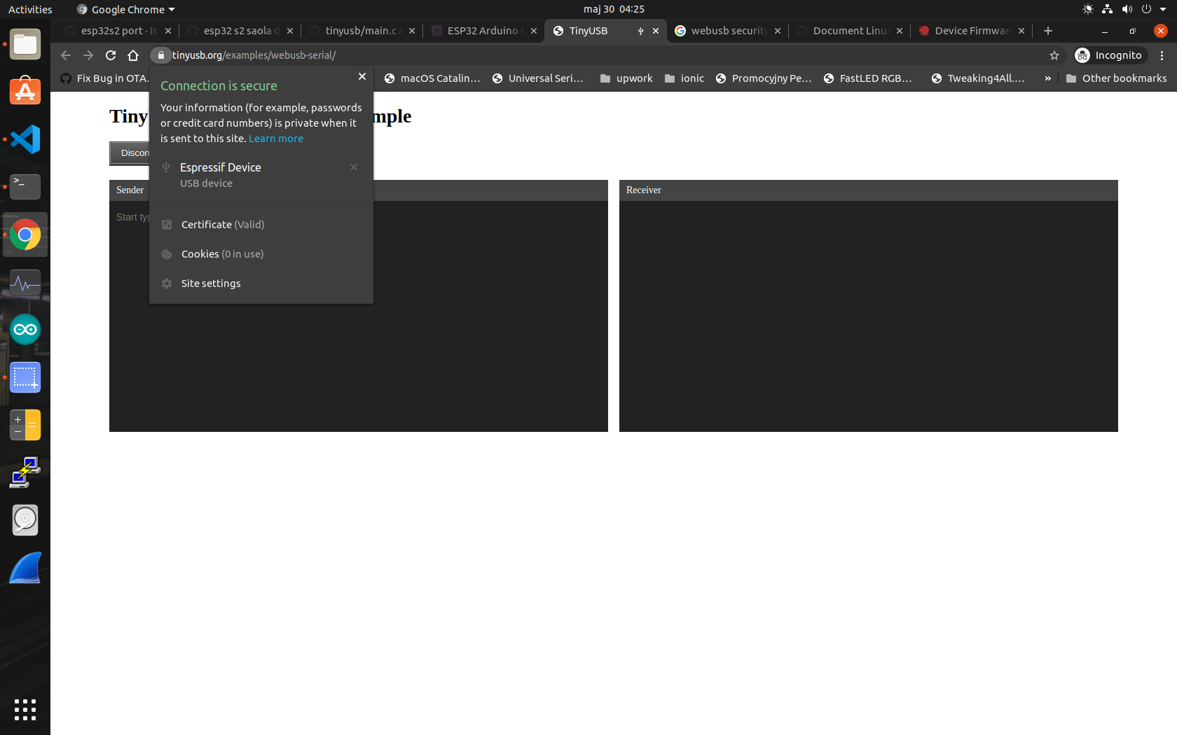

I would like to share good news. Today i finished updating tinyUSB component to master branch and have prepared 3 useful and really cool examples https://github.com/chegewara/esp-idf/tr ... herals/usb:
- CDC usb, communication device class, which allows to connect with any terminal like putty and communicate with system, possible use case AT commands etc, alternative to UART, but using native USB,

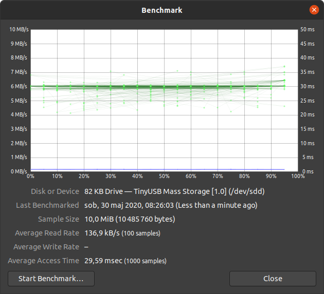

- MSC, mass storage class, can be used like a common pendrive, for now example is using only internal ram (small ram disk), possible use case - OTA update by drag and drop, adding SD card will make even more use cases,
- webUSB, usb device controlled from web browser without using wifi, currently example is using website terminal to send message to esp32s2 and esp32s2 is echoing it, also its possible to connect with putty at the same time and text between website esp32 and putty, another example project what can be done with webusb https://github.com/sowbug/weblight, another use case is setup wifi credentials and all other device setting using cloud hosted website, without need to run AP
Still few more usb device types left, like HID or MIDI.
esp-idf PRs on the way, lets hope can be merged soon.
WebUSB: MSC disk: MSC disk benchmark:

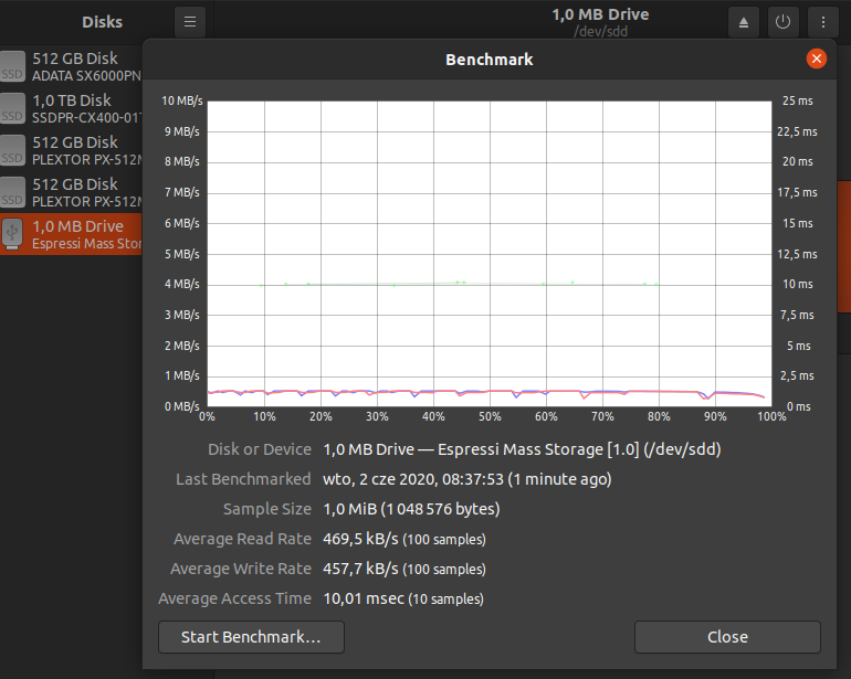

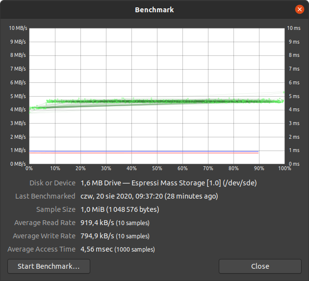

Here is another test. This time i am using port of tinyusn library with arduino as component. Board is kaluga, and disk is in spiram, disk size 1MB:

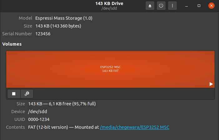

I have another cool example how to use USB on S2. This time its MSC class (mass storage) to OTA update device with drag n drop.
Its enough to copy new binary to esp32 which works like a pendrive and new firmware will be flashed and start from OTA partition.

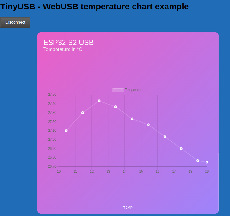

i would like to share with another esp32 S2 demo using native USB. This time i have connected DS18d20 temp sensor and data are sent to webUSB. Whenever web page is opened and connected to esp32 data are received every 500ms and last 10 records are displayed with chart.js:
I know it is possible with old esp32 and web server, but here we dont need wifi connection to esp, website is hosted on internet.

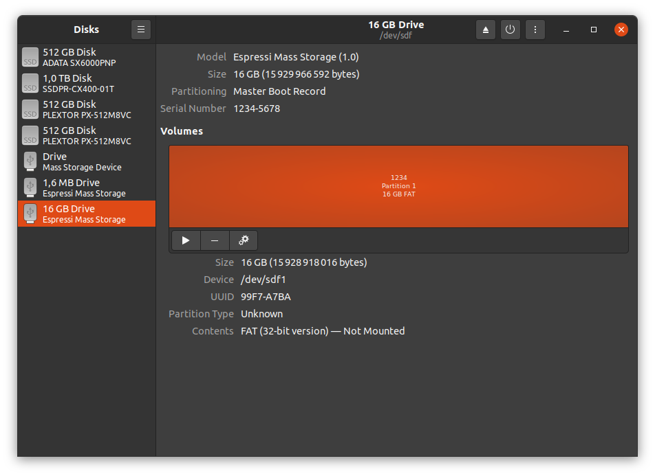

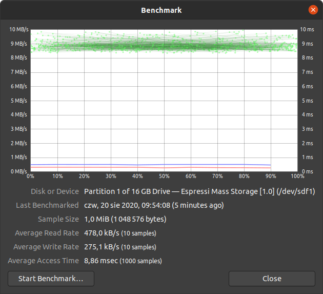

Today i would like to share good news. I have first on the world (or maybe not) working ESP32 S2 pendrive that can read SD card over SPI.
Code is working with a bit changed arduino-esp32 and my library. Its not super speed, i would say it slow, yet, but it is working and can be read/write by OS (tested with linux) and still can be read/write by esp32 like usual.
Here for comparison is benchmark of RAM disk from the same code:
