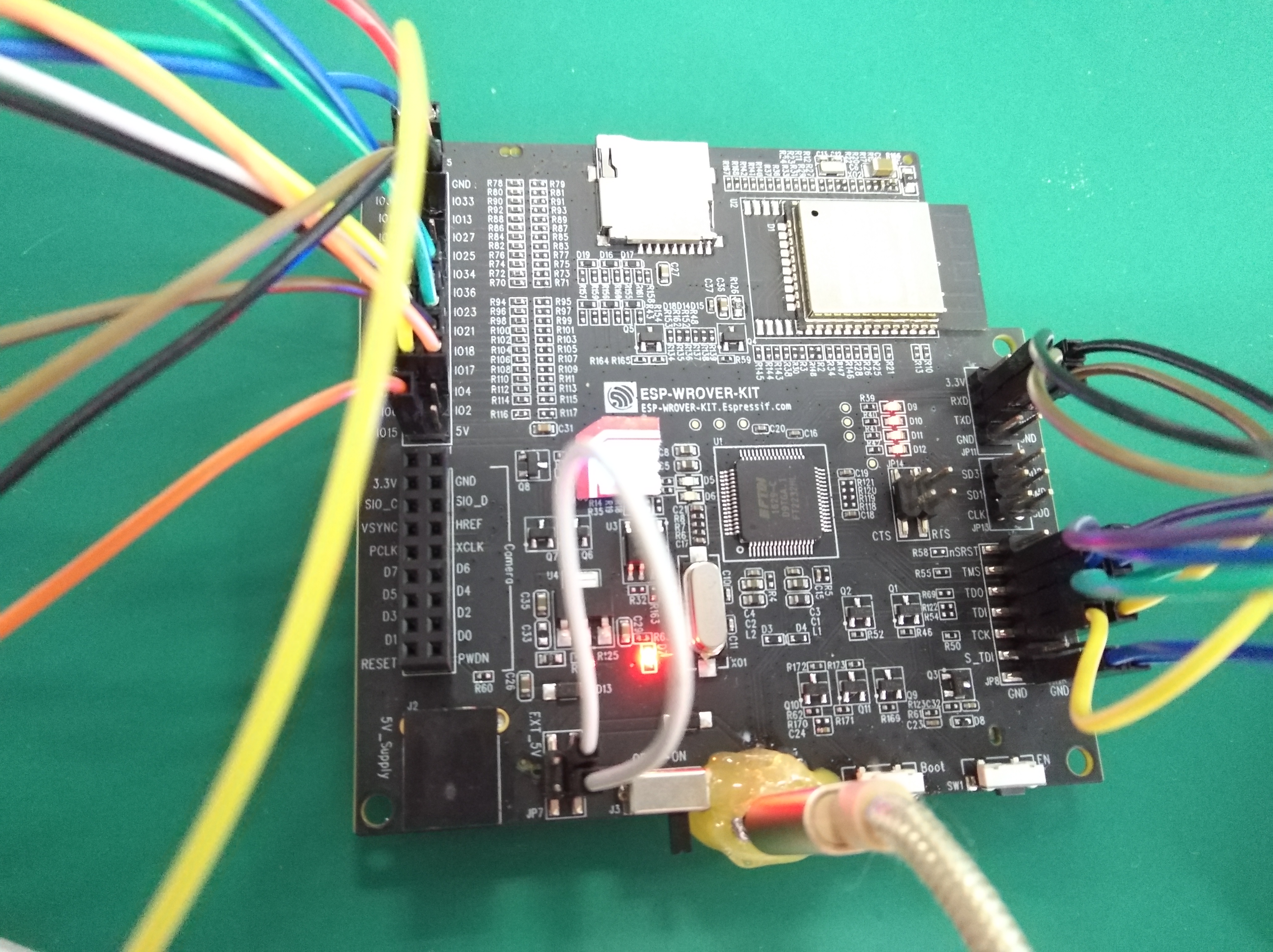

Hum. All I can see (and say) is that there's something going terribly wrong with the communication between the JTAG chip and the ESP32. Can you post a picture of the kit so I can see which jumpers are installed?

Hi dear,
Pls review the esp-wrover-kit connection as attchment. To enable the JTAG function, I use shorting jumpers on JP8 (JTAG) for TMS、TDO、TDI、TCK、GND.
By the way,the GPIO12、GPIO13、GPIO14、GPIO15 can be reused?I may be use these GPIO to connect Camera.
- ESP-WROVER-KIT.jpg (3.46 MiB) Viewed 17741 times
Re: when use ESP-WROVER-KIT,always getting the message"Localhost:3333:Connection timed out."
Are you using GPIO12/13/14/15 right now? Because if that is the case, that is the reason your JTAG does not work: re-using the pins for different purposes is possible, but it will kill JTAG connectivity in weird and interesting ways and may lead to what you've seen.
