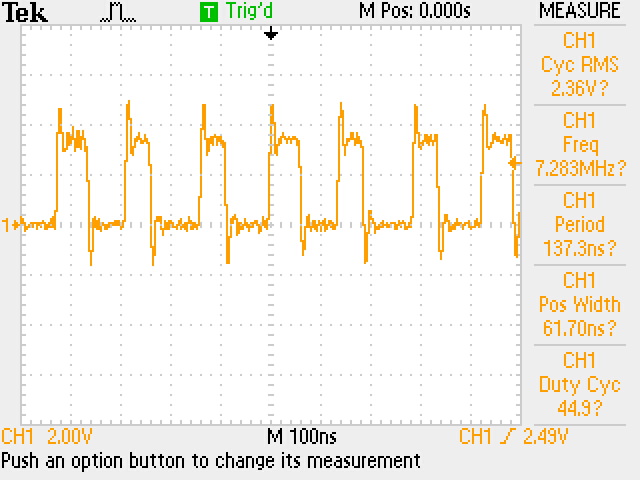

Re: Unreliable GPIO
Hi Aidin,
See the captured image from my Scope Tektronix TB1062 (60 MHz / 1 Giga Samples/s).
The correct image on the pins GPIO2 and GPIO4 is below. No problem..
Arduino code:
Arduino code:
void setup()
gpio_config_t io_conf;
io_conf.mode = GPIO_MODE_OUTPUT;
io_conf.pin_bit_mask = 0b10100;
gpio_config(&io_conf);
void loop()
GPIO.out_w1ts = 0b10100;
GPIO.out_w1tc = 0b10100;
}Retired IBM Brasil
