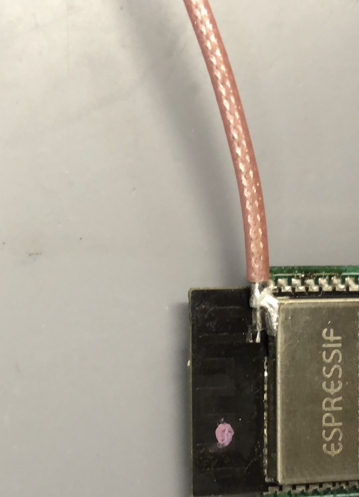

Thanks for replying
If I need to solder an antenna having a braided wire part and a solid core part on ESP32-wroom-32 then where I have to solder it to enhance the range of WiFi?
As we have lock down this particular module for our application and we are into the production.
So could you provide me a solution for this particular module which is ESP32-wroom-32 in some kind of document so that we will get surety that this will never fail?
Please provide the details at the earliest.

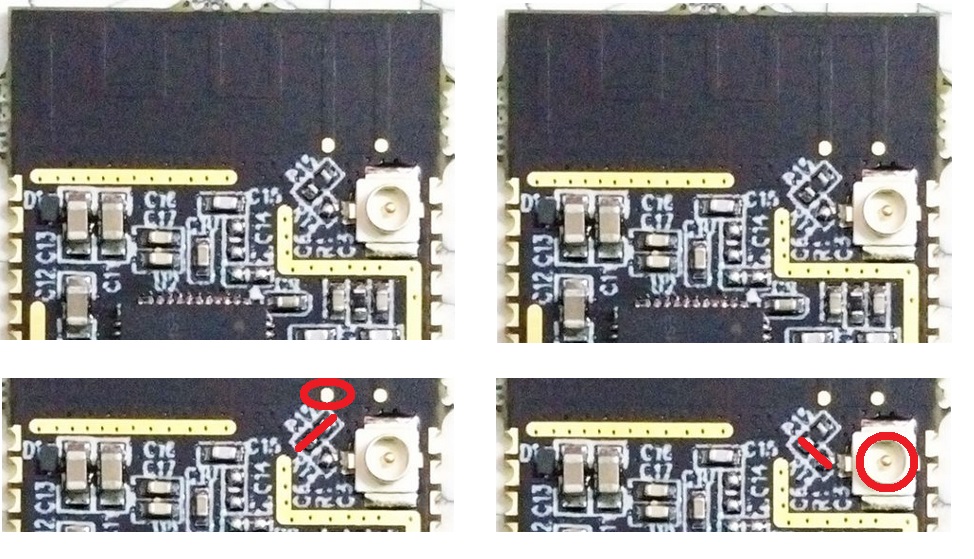

Re: Guidelines for external antenna layout
Hi, mehul_dudeja
Please cut off the RF trace after feed point of antenna and weld the external antenna on the feed point of antenna, as is shown in the picture.
Thanks.
Thanks.

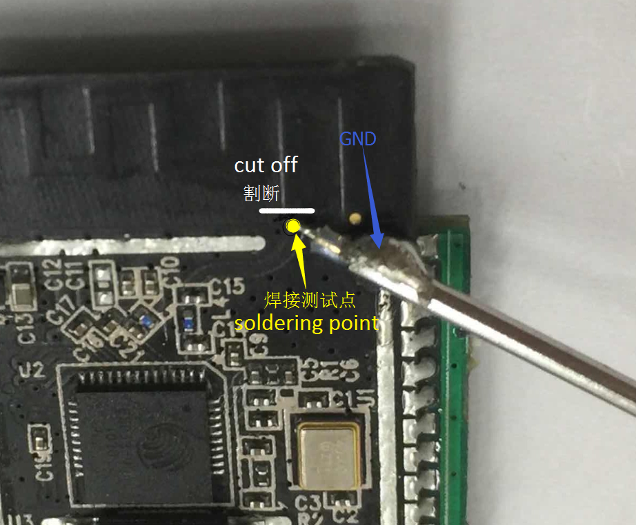

I have seen the photo but could you please send some clear photos or some kind of document by Espressif(official) if possible, in which I can see clearly which point needs to be solder to the feed point and which point needs to be solder to the braided wire.
Thanks
Mehul
Hi, Mehul
Sorry for the inconvenience caused by the not-clear photo, we have drafted a clearer photo and hope this one helps.
Thanks.
Thanks.
- PCB天线改传导测试.png (661.81 KiB) Viewed 27653 times
