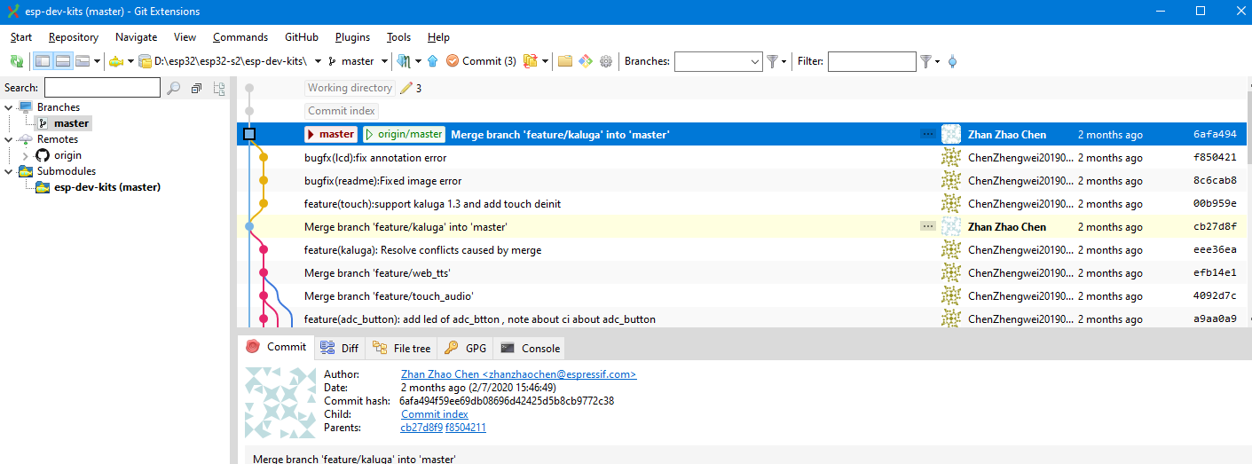

git status
I have used the master branch. The problem is still there.
D:\esp32\esp32-s2\esp-dev-kits (master -> origin)
λ git pull
Already up to date.
λ git status
On branch master
Your branch is up to date with 'origin/master'.
Would I get the tag release to work on the DK board?
git status
