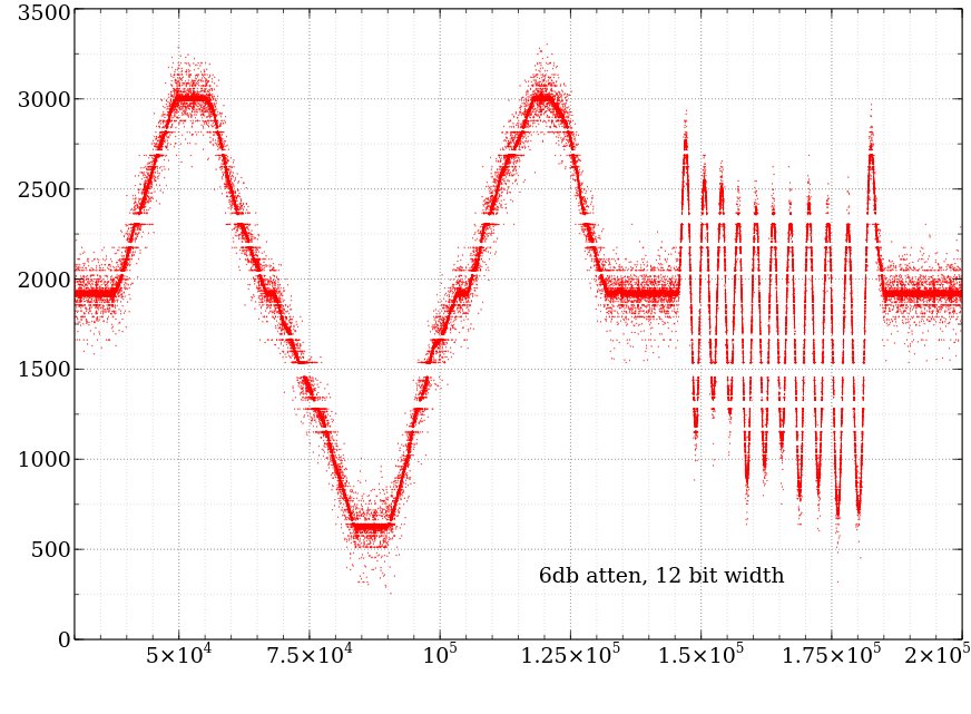

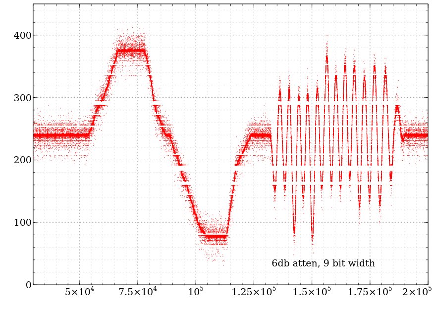

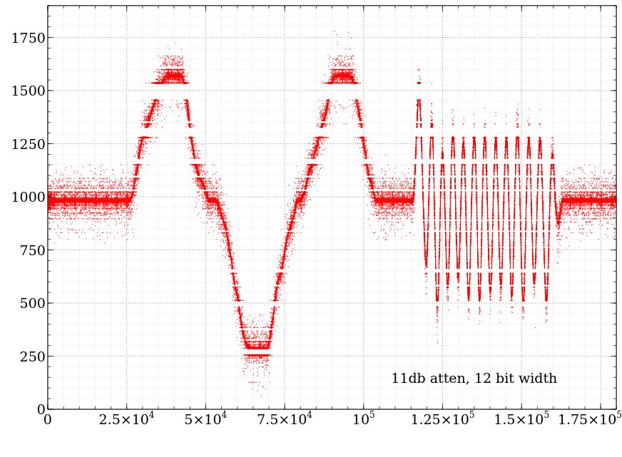

I'm trying to run multi-channel DMA based ADC and I'm getting some strange results. Since this config isn't supported by the APIs I've had to manipulate the registers directly so it's possible I've done something wrong, but it isn't immediately obvious how an ADC could be misconfigured to behave like this. In the following plots I have simply logged the raw values returned from the ADC and plotted each sample as a dot. It's clear that there are multiple voltage regions in which no samples are ever returned. The problem remains with different bit widths and attenuation settings (although I can only try the 6 and 11 dB settings without adding a resistor network on the input).
Has anyone run into this before or have any suggestions?

As an update, I created a simplified test case that only reads one channel and doesn't use any of my dubious register hacking, and it still shows the same behaviour. I've tested on three different esp32 and all behave in the same way, so it's not a single bad chip, and with different sources for the analog input, including the signal generator on my oscilloscope. I confirmed that the problem isn't visible when using the synchronous (non-dma) APIs.
The attached chart is from the single channel test case.

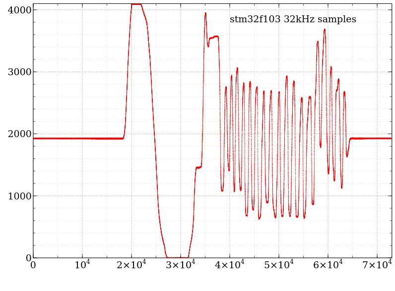

In the mean time, I've implemented multi-channel ADC on an STM32F103 and the data looks good. The following is a similar setup to the esp32 tests, raw results from one of four channels that were being sampled plotted as individual dots.

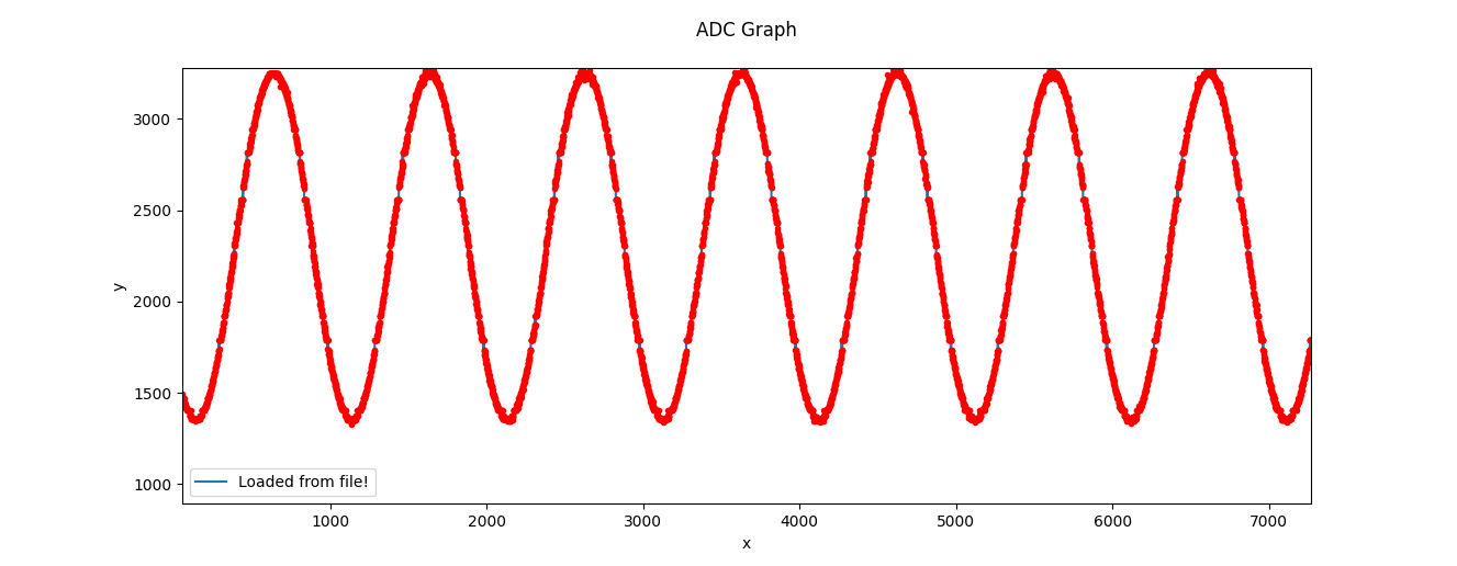

Sadly it wasn't the LNA causing problems, I get the same thing if I use ADC channel 4. I made a small test case to demonstrate the problem using the DAC to output a sine wave as a test signal. It was written for platformIO with the arduino framework but is small enough that it should be easy to port.

I'm getting the same thing you have , even when I pulled it low .. same result
