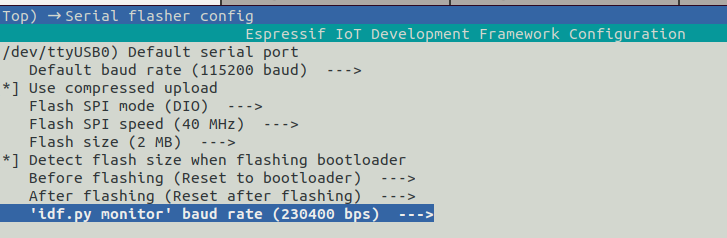

I want to change the baudrate of the make monitor for esp32, but after I change it in the make menuconfig and then make flash and monitor the output I only see a bunch of scrambled characters. I tried many other baudrate as well, but only the default 115200bps will print out readable characters. Could anyone help me on this please?
This is the config I have changed:
Screenshot from 2020-10-12 13-44-56.png (43.2 KiB) Viewed 8692 times

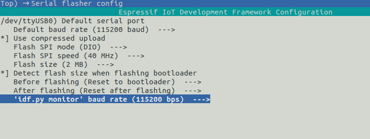

and this is the make monitor output:
Screenshot from 2020-10-11 15-58-49.png (43.6 KiB) Viewed 8692 times
Thank you very much

This only changes the baud rate on the PC side. You also need to change the baud rate accordingly on the ESP32 side.

2 things:
1) bootloader logs always are printed with 115200, so you will see garbage with different baudrate
2) you can use make monitor ESPBAUD=__baud__ command to change monitor baud rate, try it please

by Sprite
2 things:
1 is correct, but 2 will only (again) change the PC baud rate. A correct answer is that you can configure it via menuconfig: Component config -> Common ESP-related -> UART console baud rate. Note you need to select 'Custom UART' under 'Channel for console output' before you can configure that.
