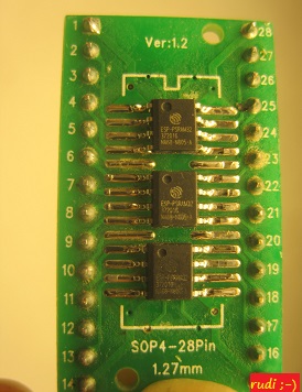

now i am ready here for PSRAM testings ;-)
txs
( for fast provisional testing only - PCB is in work )
have parallel things here now for reference and other testings ready for go on
