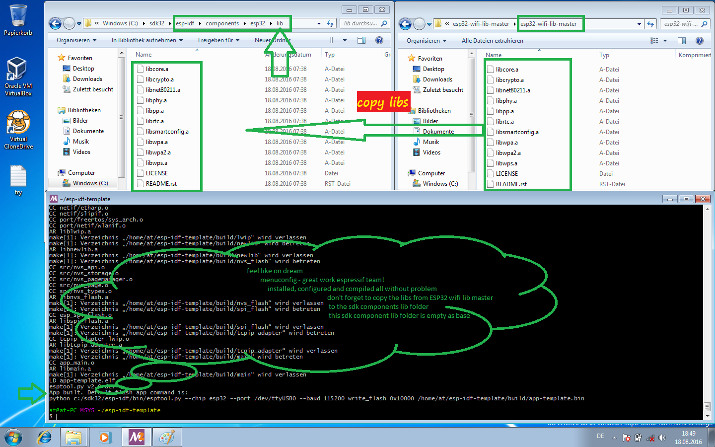

hi jeroen,
txs, nice work
1++
happy to see many things now that was on dreaming.
btw:
one suggestions to users:
dont forget to copy ( or unpack ) the libs to the sdk esp32 components lib folder
and you go on too.
btw2:
if you not have installed,
install python ( 2.7.12 ) and if you use windows check the com name in the esp tool python file.

- first_try.png (291.44 KiB) Viewed 21541 times
