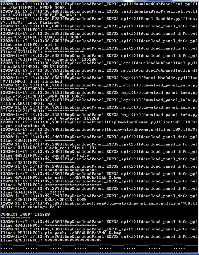

I have an issue with ESP download tool v3.8.5, when I tried to erase o program the ESP32 the console print .....____.....____ endlessly, like photo below.

ESP download tool uses the serial port (TX/RX, plus IO0/Reset to get the device into download mode automatically), not JTAG.
