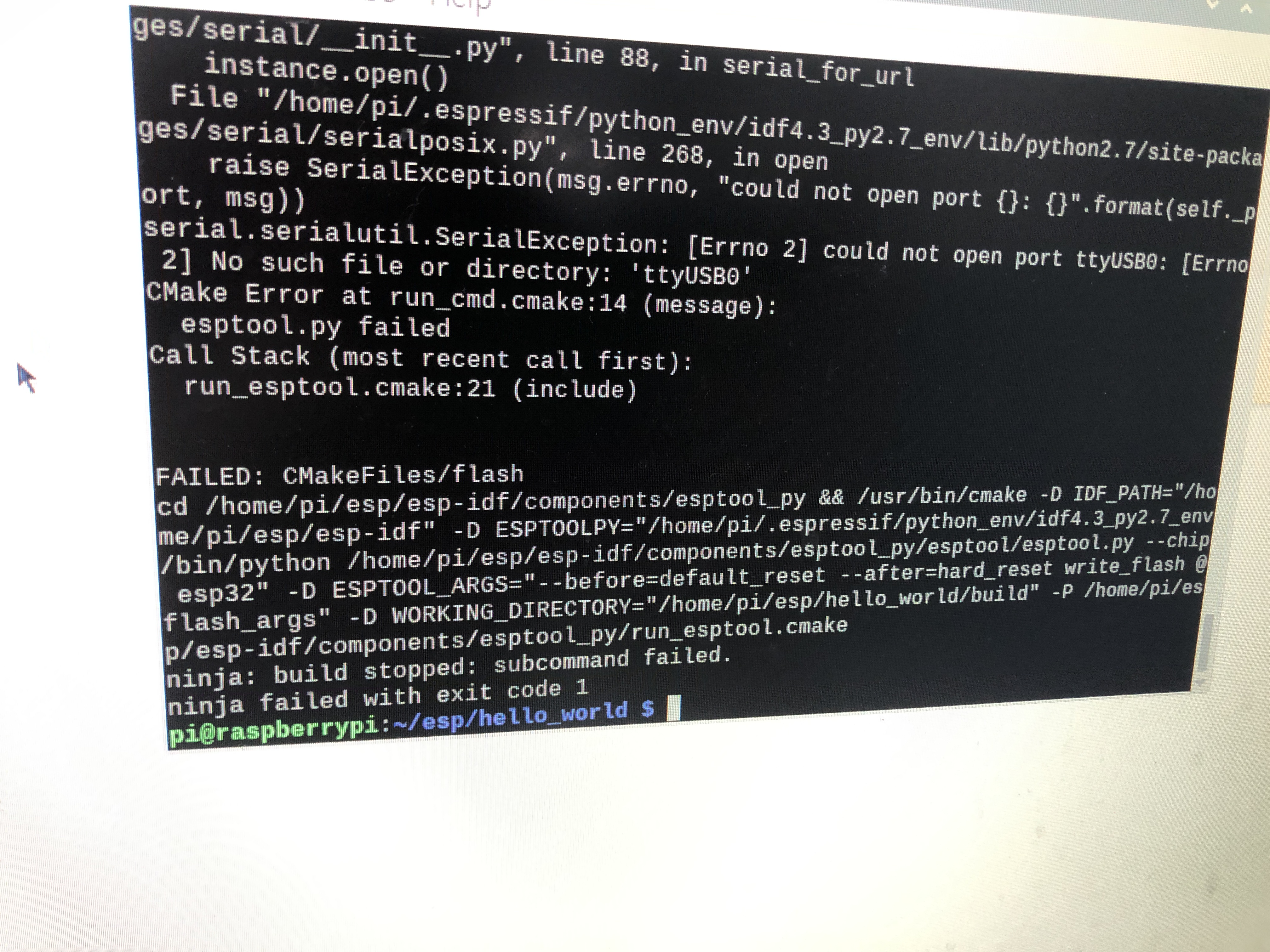

Hi there.
How can I solve this problem?
I've already finished 'idf.py build' but I can't finish 'idf.py -p PORT flash'
flash가 안돼.jpg (2.85 MiB) Viewed 4025 times

have you used "ttyUSB0" or "/dev/ttyUSB0"?

I typed "idf.py -p ttyUSB0 flash" and than I faced that error.

oh thanks I solve that. I need to type /dev /tty~
