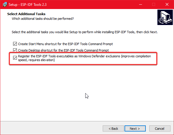

I installed the ESP-IDF successfully, started with the Eddystone project, copied all files into a project folder (discovered the hard way that I need to copy the 'raw' file..) and 'build' the project.
The build task, while it is processing, seems to be showing the number of obj files being used, which started from 04/1165 and after 30 minutes was still at 65/1165 ! Why would the 'build' task take such a long time ? At the rate at which it was going, it would have taken 10 hours to build !!
I did not see any errors, except the "Missing PERL_EXECUTABLE" error, which as per your answers elsewhere in the Forum is not relevant and can be ignored.
I closed all other applications on my Laptop, the Task Manager showed very nominal usage of CPU, Memory & Disk, my Laptop has i5 CPU & 8GB of Memory...so, what am I missing ?
I had to terminate the build process as it did not make any sense to continue at this rate !

Hi Synectix,
the slow compile speed may be due to your antivirus software.
Please reinstall IDF-tools using the installer.
The installer registers the tools as Windows Defender exclusions to improve compile speed. After that, check if the issue persists.
If this doesn't fix the issue try disabling your antivirus software and post which antivirus you are using.

Thanks. Problem solved !
I am certain that I had enabled the "Windows Defender Exclusion" checkbox when I installed it the first time too.
Anyway, I uninstalled the esp-idf and re-installed with "Run as Administrator" option.
Now the eddystone project's build time is about 4 min 30 seconds !
