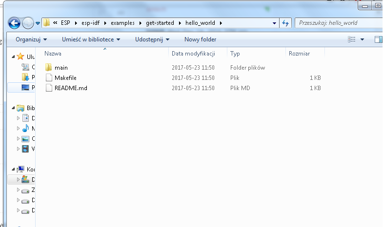

Re: Setting up Development Toolchain for ESP32
Posted: Tue May 23, 2017 2:05 pm
by sintech
Dir where you run 'make' should have 'Makefile', for example "esp-idf/examples/get-started/hello_world"
Posted: Wed May 24, 2017 5:22 am
by wind_energy
There it is.
I don`t know...maybe I should start installation at the beginning? Remove all and then start again?
