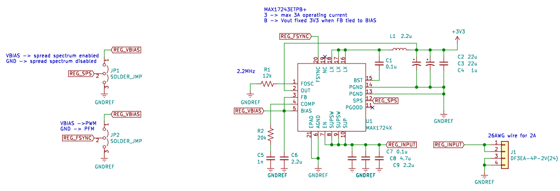

Re: Custom ESP32 board WiFi connection issues
Above is the power supply I used for the board. Its the MAX17243ETPB. It has a 3A limit, so should be well within the specs of my board, since the ESP while TXing is the largest power draw on my board (~500mA from ESP32 datasheet if I remember correctly).Share your schematic.
Often suspect the power supply with wifi issues, it is the highest power draw function.
The two jumpers JP1 and JP2 are both grounded on the actual board, so the MAX17243 should be in PFM mode with spread spectrum disabled. This is not a big requirement, and I can modify the jumpers. Will look more closely at the regulator config right now actually.
One thing to note is that currently I'm powering the board from a 9V battery because I am a lowly student and don't have access to a power supply. Possibly the current draw of the ESP32 is just too much for this poor battery.

Yeah, 9V batteries generally have a very poor internal resistance; it would certainly not be my first choice to run an ESP32 off. However, if that were an actual issue, I'd expect the ESP32 to brown out. Still, connecting something else to it (lab PSU? USB power bank?) could give some insight.
