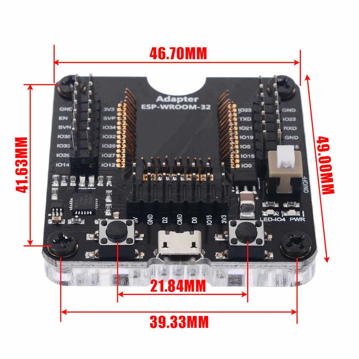

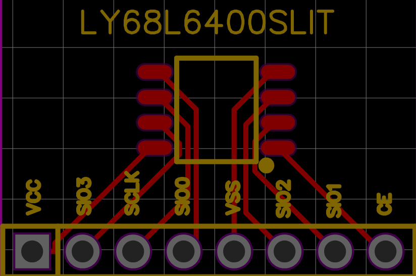

I want to attach PSRAM memory LY68L6400SLIT with Espressif ESP32-WROOM-32 2.4GHz WiFi+Bluetooth chip. Iam using wroom adapter, I am using barebone chip. I assume that this is possible, as I have found tutorial online http://blog.pagefault-limited.co.uk/lol ... pgrade-mod but got trouble an any connection I have tried did not work.
I have tried following combinations (memory chip -> esp chip):
CE -> d3
SIO1 -> io17
SIO2 -> d0
VSS -> gnd
VCC -> 3.3V
SIO3 -> cmd
SCLK -> CLK
SIO0 -> d1
chip boots but ps memory is undetected
CE -> io16 + 10K pul up resistor
SIO1 -> d0
SIO2 -> d3
VSS -> gnd
VCC -> 3.3V
SIO3 -> d2
SCLK -> io17
SIO0 -> d1
this combination crashes chip prior booting
I am looking for guidance what is the propper combination to connect memory chip via QPI interface.
memory module
Screen Shot 2021-03-21 at 14.27.11.png (70.75 KiB) Viewed 11788 times
New-Electrical-Socket-Programmer-Tool-ESP32-Adapter-Socket-For-ESP-WROOM-32-Module-Micro-USB-Type.jpg_q50.jpg
adapter
New-Electrical-Socket-Programmer-Tool-ESP32-Adapter-Socket-For-ESP-WROOM-32-Module-Micro-USB-Type.jpg_q50.jpg (98.06 KiB) Viewed 11788 times

Re: ESP32 WROOM-32 with PSRAM Module
Postby Sprite » Mon Mar 22, 2021 2:29 am
Suggest you look into the datasheet for the specific WROOM32 module you have. Some of them do not have the flash pins connected to the castellated pads.

Postby petercipov » Mon Mar 22, 2021 7:25 pm
Hello
I have removed metal chip case. I used multimeter to find which exact flash pins are connected to chip pins, I have found following
(flash PIN -> esp32 pin)
CE -> not connected to pin
SIO1 -> d0
SIO2 -> d3
VSS -> gnd
VCC -> 3.3V but no direct connection to pin
SIO3 -> d2
SCLK -> clk
SIO0 -> d1
I have used this combination already with CE and SCLK of PSRAM connected to io 16, 17. this crashes my esp32 chip.
