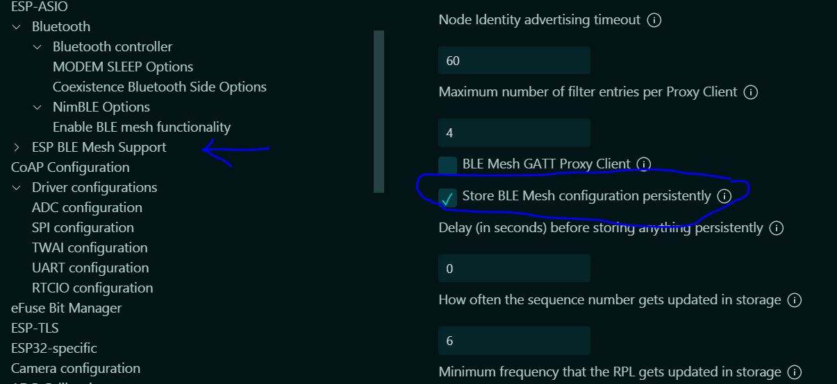

m using NimBLE mesh on ESP32. But Provisioning and configuration data is not being stored on Persistance storage. I have enabled BLE_MESH_SETTINGS. But there is no config.h file.
I am getting an error of config.h file not found.

Can anyone help, please?
I am using example available in this folder:
I have enabled the BLE_MESH_SETTINGS from C:\esp\esp-idf\components\bt\host\nimble\port\include\esp_nimble_cfg by making this change:
When I build the project after enabling _BLE_MESH_SETTINGS, I am getting this build error:
This is the SDK config file I am using.
esp-idf/examples/bluetooth/nimble/blemesh/
#ifndef MYNEWT_VAL_BLE_MESH_SETTINGS #define MYNEWT_VAL_BLE_MESH_SETTINGS (1) #endifCode: Select all

I love to build projects with ESP32 using Arduino and Esp-idf like Web servers https://microcontrollerslab.com/esp32-e ... eb-server/
Re: NimBLE mesh on ESP32 ( Provisioning and configuration data Persistance storage issuse)
Its quite confusing the nimble mesh and the esp ble mesh. Both are nearly together and there is no clarification about it. Actually if you want to use the ble mesh in esp32 as per the examples, you have to enable the esp ble mesh, not nimble mesh. For persistence storage check the box "Store BLE Mesh configuration persistently". Then add these lines for initialization of the nvs flash in the main function
Remember to start the new project and reset all the changes which you made to the default state before starting.
thanks!
esp_err_t ret;
ret = nvs_flash_init(); // intitiating the nvs flash
if (ret == ESP_ERR_NVS_NO_FREE_PAGES)
ESP_ERROR_CHECK(ret);thanks!
