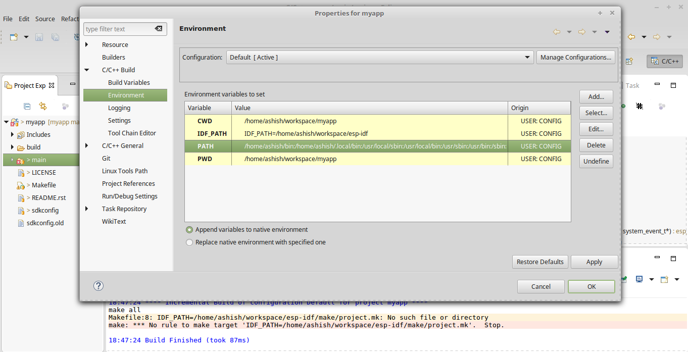

I am able to make and upload the flash in esp 32 by terminal in linux and it is working properly.
As per the Kolban book I tried to setup the environment in eclipse and my path variables are shown in the picture as in attachment.
I am trying to build the project and I am encountering the error
18:47:24 **** Incremental Build of configuration Default for project myapp ****
make all
Makefile:8: IDF_PATH=/home/ashish/workspace/esp-idf/make/project.mk: No such file or directory
make: *** No rule to make target 'IDF_PATH=/home/ashish/workspace/esp-idf/make/project.mk'. Stop.
18:47:24 Build Finished (took 87ms)
Now when I run the make commands in the workspace project file manually in terminal, it works perfect. Although I am using the same PATH variable for IDF_PATH.
IDF_PATH for make file is not working when setting in eclipse

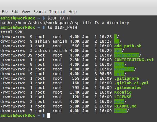

In your image, it looks like the variable "IDF_PATH" points to the directory:
What is actually **in** that directory? The IDF_PATH variable should point to the root install directory of the ESP-IDF SDK. This should be the content of the GitHub repository as seen here:
https://github.com/espressif/esp-idf
Could you go to the directory where your IDF_PATH points and run "ls" and post the results?
Also check permissions down the path. As the user that Eclipse is running as, change directory one at a time to:
/home
/home/ashish
and then validate that "project.mk" exists at that final location and has permissions to be read by the Eclipse user.

Re: IDF_PATH for make file is not working when setting in eclipse
@ashishespdev
You have IDF_PATH variable with the value "IDF_PATH=/home/ashish/workspace/esp-idf"
It is not strange that the path connot be found.
The problem is that eclipse is looking for a fully qualified path. Something like IDF_PATH=c:/msys32/home/ashish/workspace/esp-idf, depending on where you've installed it. Note that it wants forward slashes, not backslashes that a windows 7 shell would want.

@kolban
SOLVED
The contents of the directory pointed by IDF_PATH is shown below. It was eclipse mars. I avoided to use eclipse neon since I had some settings and installed tool-chains, plugins. Switching the IDE to neon from eclipse solved the problem and now it is working fine.
