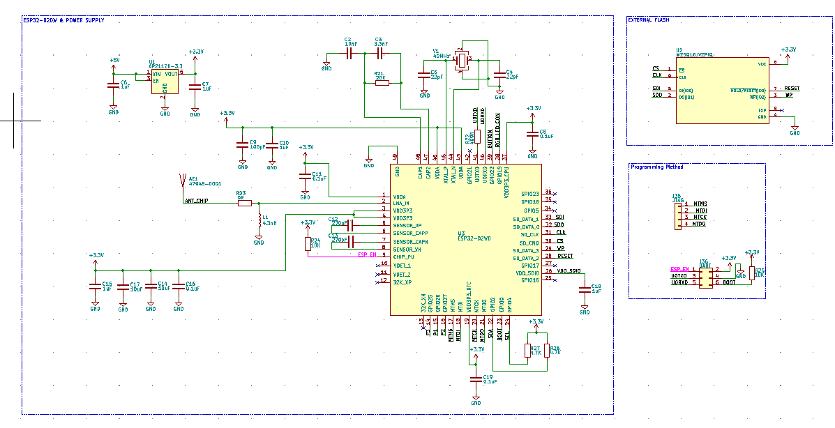

Dear,
Please find below the Schematic connection of the ESP32-D2WD SOIC based custom board design.
I use the ESPProg UART flash method to flash code.
I am successfully able to detect chips as well as able to flash a code using Arduino IDE.

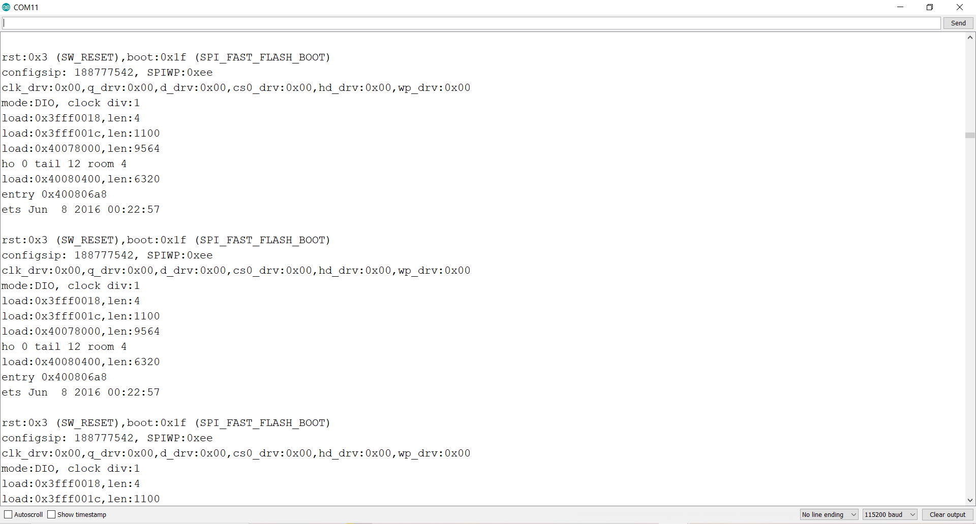

But My issue is code does not run except what we write.
I got continue 115200 Serial rate data over the terminal monitor.
Can anyone confirm what is the exact issue?? based on data its continue SW RESET.

- Serial Monitor Show it's SW RST continue
- Serial Monitor.PNG (69.64 KiB) Viewed 7769 times
- Its Pin connection diagram of ESP32-D2WD IC.
- Connetion.PNG (36.5 KiB) Viewed 7769 times

You are aware that the D2WD chip already has 2MByte internal flash in it? Connecting an external flash to the same pins the internal flash is on probably leads to issues.

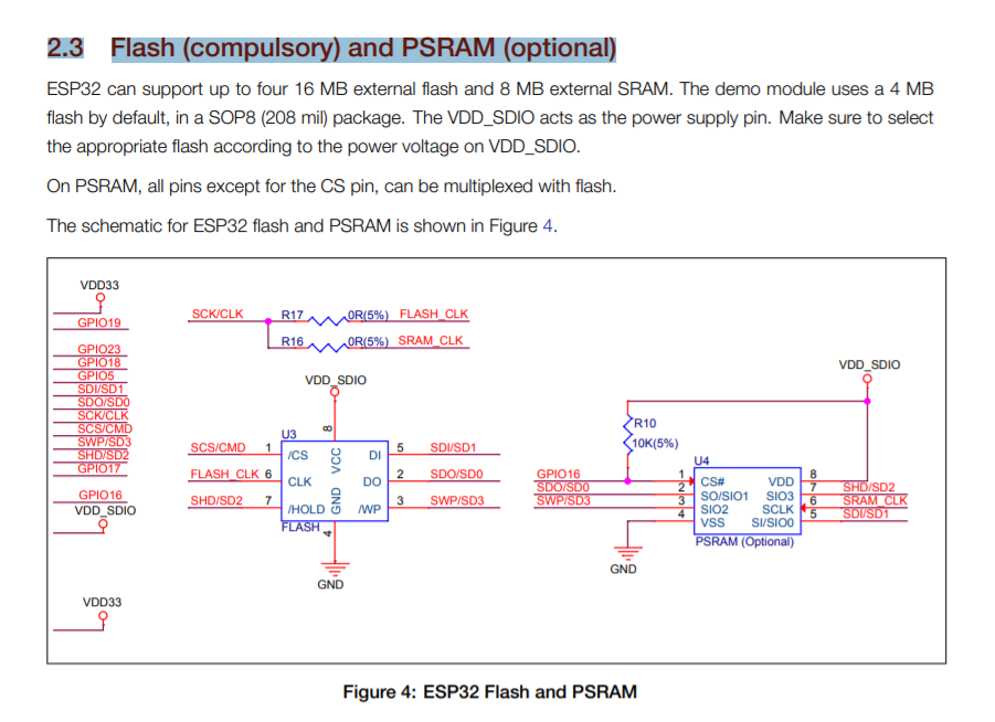

I don't think the issue is we use an external flash.
We already try the design without EEPROM a month ago and we got an issue that can not upload/Flash chip so based on the forum we got the solution to add external EEPROM.
Also, have you check as per Espressrif reference design document page 10 (2.3 Flash (compulsory) and PSRAM (optional))
How we identify internal flash use that one pin ??? Also, We do the same pin connection as well as guide by ESP32 reference design.
https://www.espressif.com/sites/default ... nes_en.pdf
So I don't think it's a flash issue.

- External Flash must be required for all ESP32 chips.
- Flash.PNG (170.92 KiB) Viewed 7710 times

Esp32-d2wd is special, it has "external" flash die placed inside the package. Also it is 1.8v flash. It uses pins 16&17 for clk and cs and efuse are burned to use these pins. So you should use esp32-d0wd with separate flash chip.

Bootstrap it to 1.8v vddsdio and hope the flash was not damaged when you were running it at 3.3v. if it isn't working post the logs from flashing and booting and espefuse dump.
