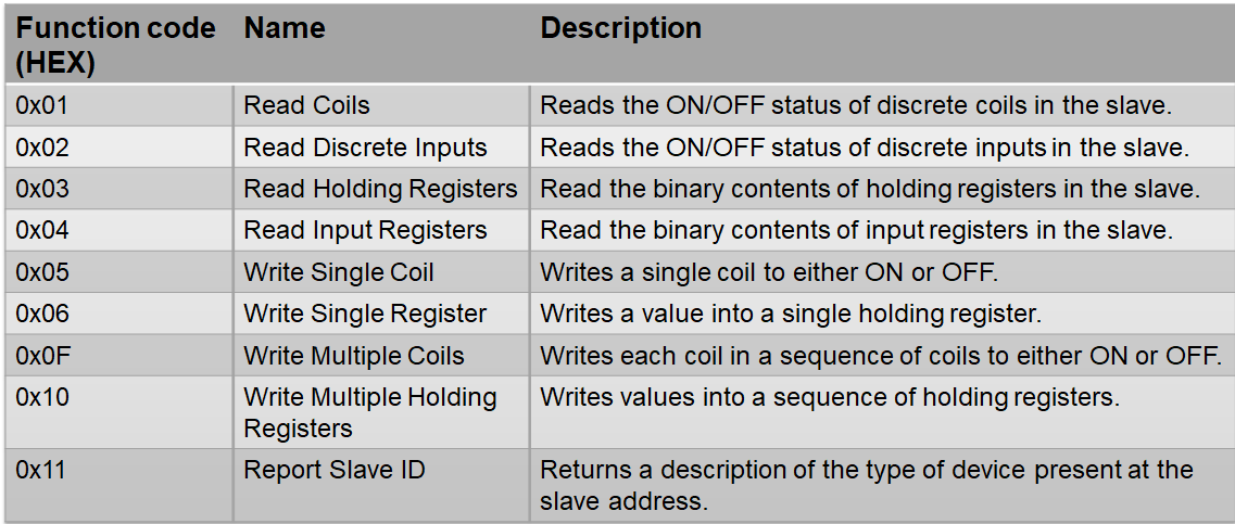

The ESP-Modbus supports the standard set of Modbus commands.
Standard Modbus function codes supported by ESP-Modbus
The PZEM-004T uses some subset of cusom commands (as such 0x41, 0x42) that are not standard and can not be suppurted by ESP-Modbus stack. However architecture of the stack allows to extend list of commands by adding function code handler function and register it in the

These functions will not be added to support because they applicable to only PZEM-004T device. There is a way to override functionality of the stack and add your custom commands as described above.
