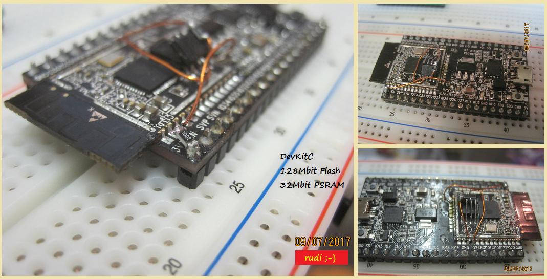

got some express parcels this weekend ( 1.8 flash, psram and other things )
and had a fast try on it from saturday over sunday morning
1. test mod with nano32 and 1.8V 128Mbit and 1.8V 32Mbit psram successful
but we have no shematic on nano32 ( Gravitech & MakerAsia )
so we can only think what is connected.
i used
PSRAM #CE -> GPIO16 and pulled up 10K VDD_SDIO
PSRAM CLK -> GPIO17
Datapins was shared with flash
MTDI ( GPIO15 ) was pulled up VDD3.3 for VDD_SDIO 1.8V from SoC regulator
next test
2. test mod with DevKitC and 1.8V 128Mbit and 1.8V 32Mbit psram successfull
and here we have on Hardware Resources -
- ESP32 Module Reference Design
- ESP32 Development Board Reference Design
i used the same again
PSRAM CLK -> GPIO17

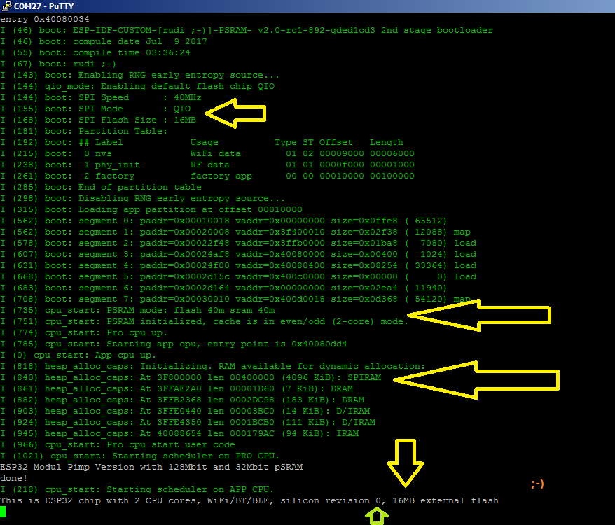

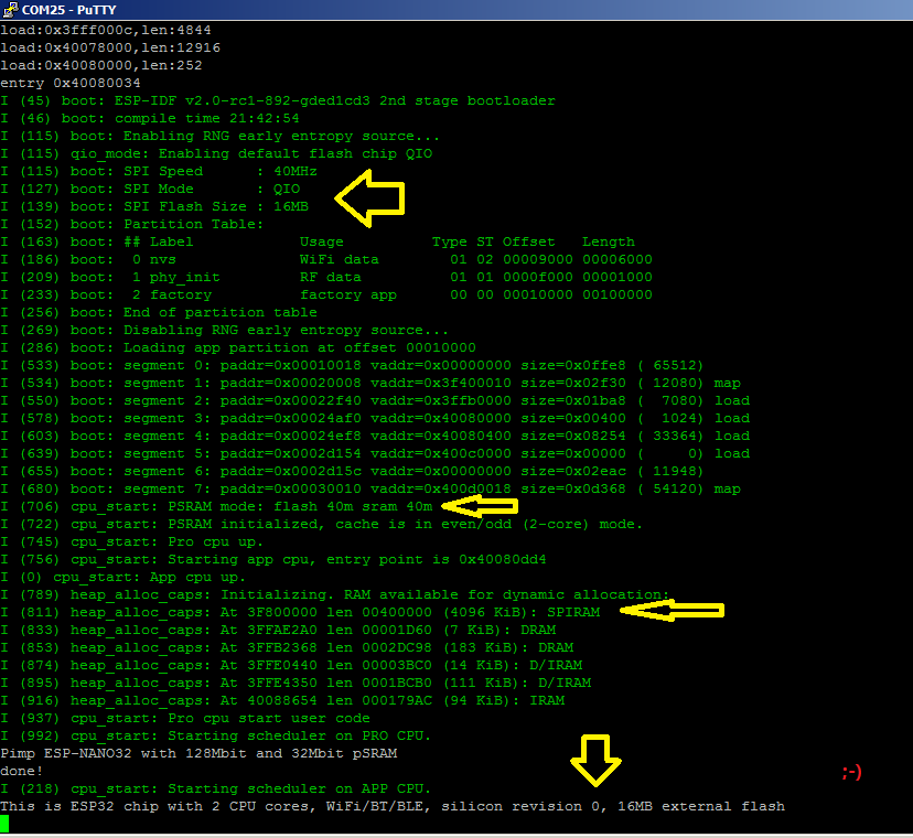

and the log looks like this:
pimped Nano32 with 128Mbit Flash and 32Mbit psram :
pimped DevKitC with 128Mbit Flash and 32Mbit psram
never give up until you finish your work
sry for the bad soldering - but had no scope on this fast try .

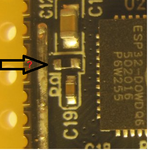

i think you have no DevKitC on the hand?
you want know the secret?
make this test:
take the DevKitC
de solder the Wroom Case shield that you see the SoC and Flash
connect the DevKitC
do a measuring on VDD_SDIO VCC ( flash pin 8 ) and GND
what you get?
now make the same with pull up directly MTDI bootstrap pin to VDD3.3
boot again
what you get?
so long espressif, jeroen and ivan makes silence on wrover shematic
so long we can not talk here open over this "mystic"
and there is no "conspiracy" WiFive - its fact.

Re: ESP32 PSRAM support
@WiFive
same here
forget my last 2-3 postings
the boostrap wire was done on wrong IO15 here too.
holy moly
( jeroen i hear you laughing - but you have right )
where is the next corner
i am so small now
same here
holy moly
i am so small now
