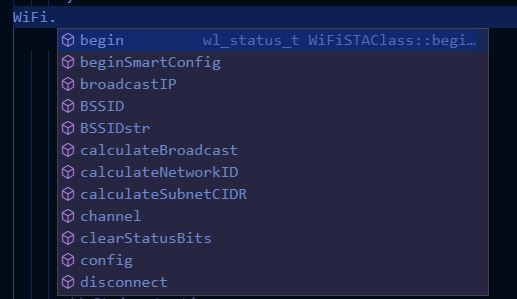

How would I stop that WiFi.begin 'connect task' ?
It seems to me the ESP32 is quite eager to being connected to the internet/network ..
Re: WiFi.begin(ssid, password) and timeout
Posted: Thu Apr 15, 2021 10:43 pm
by gfreund
WiFi.disconnect()
~G
