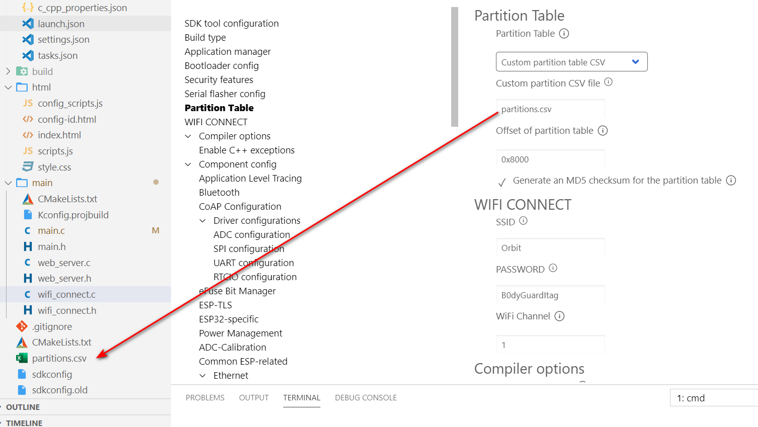

According to your project attached on the other post, you are missing the definition of the csv file.
and you need also to change the flash memory size. Here the code works!

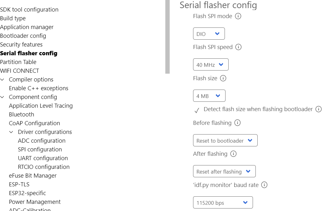

The project uses WROOM32 with 4MB of flash.
I set the flash memory size in the config in vscode to 4MB.
Why would 3 different projects all start having issues with spiffs. Is there a setting in vscode that is independent?

Attached shows my flash size and partition definition settings

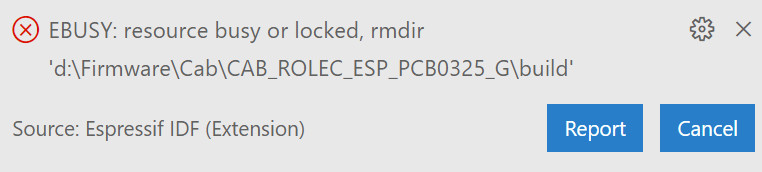

One thing I do note that I did not see in past is that when I click on icon in vscode to do full clean I get an "ebusy:resource busy or locked" error as attached.
