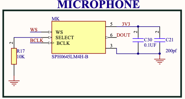

I am trying to connect I2S mic (SPH0645LM4H-B mic) to ESP32 with no luck.
my code is given below:

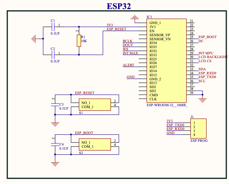

const i2s_pin_config_t pin_config = {
.bck_io_num = GPIO_NUM_34, // Serial Clock (SCK)
.ws_io_num = GPIO_NUM_32, // Word Select (WS)
.data_out_num = I2S_PIN_NO_CHANGE, // not used (only for speakers)
.data_in_num = GPIO_NUM_35 // Serial Data (SD)
pinMode(GPIO_NUM_35, INPUT);

however all i am getting is 0s. Can somebody help me?
i would greatly appreciate any help on this.
I have attached Circuit Diagram. Pl find it in the attachment.
