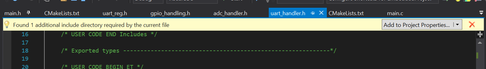

I am trying to use UART in interrupt mode but when I am receiving anything, the controller keeps on resetting.
I am using Visual studio 2015 with GCC version 8.4.0, GDB version 8.1.0 and esp-idf v4.3.
At first uart_reg.h file was not inlcuded but when I added the header it flagged pop-up attached in image.

Hello Ashvajit.P,
Unfortunately your interrupt handling code will not work because:
1. When you setup interrupt you allocate the IRAM-Safe Interrupt Handler but do not add the `IRAM_ATTR` attribute to the handler function.
Refer: https://docs.espressif.com/projects/esp ... t-handlers
2. There are some constraints of using IRAM-Safe Interrupts. It is not possible to use the `uart_read_bytes(), malloc(), free()` and ESP_LOGI() macro inside the interrupt handler because it can call only the RTOS functions with prefix `XXXFromISR()` and functions that are located in IRAM and can correctly access the data in DRAM segment, RTC memory only.
3. In case of IRAM-safe interrupt you should use the HAL functions to read/write data from UART FIFO or directly read/write data to peripheral registers.
4. It is possible to implement non IRAM-Safe Interrupt and place ISR handler into flash memory but it might be interrupt latency when flash access functions are used (disable CPU cache).
I modified your code to use the custom ISR handler and buffer received data using ring buffer.
The code is published here:
https://github.com/alisitsyn/modbus_sup ... al_example
The code might be with some mistakes but it works. The static variables are placed into DRAM by default and it uses the HAL macro which exist starting from (ESP-IDF v4.1). If you need to implement the same on version v4.0 or less it requires to implement similar code with direct access to registers.
Hope it helps. Let me know if you have any questions.
