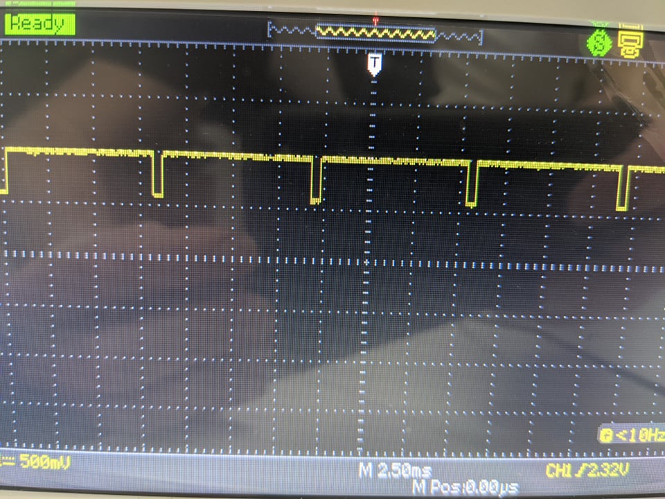

I am trying to essentially blink an LED in ULP with the circuit setup so that the GPIO is a current drain. This is working fine except that the off mode is still operating at ~2.1V when I'm expecting 0V.
ESP32s2 scope.jpg (138.93 KiB) Viewed 1685 times

Any ideas as to what code is needed to actually turn the GPIO off? Or will there always be leakage when operating the GPIO as a current drain?
