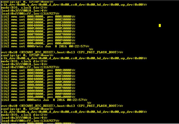

I am using ESP32-WROOM-32D IC for wireless communication. But issue is ESP32 is continuously getting rebooted. Even have checked 3.3V supply is going to ESP32 IC.
I am not getting what is the issue.
I have attached the image I am getting from ESP32 on console.
Please suggest what is the issue and what to be done when this kind of issue occurs.

Looks like incorrect flash setting to me. I have blogged about this error, it is kinda common:
https://pcbartists.com/firmware/esp32-f ... op-solved/
Are you using a WROOM module with more than 4MB flash?
