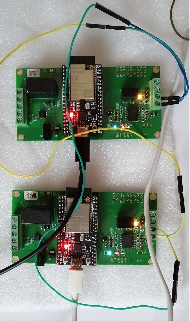

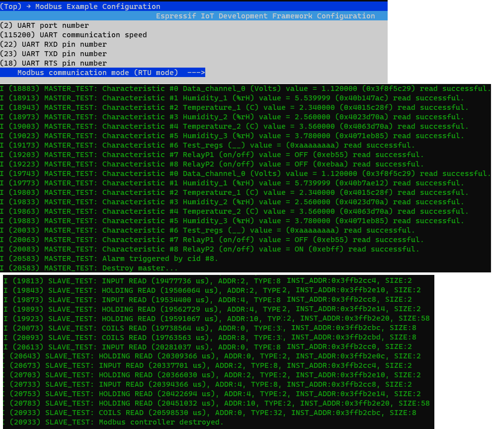

- Modbus communication opts and logs
- master_example_opts_comm.png (178.21 KiB) Viewed 14600 times
- Modbus customized demo boards
- boards.png (1.98 MiB) Viewed 14600 times

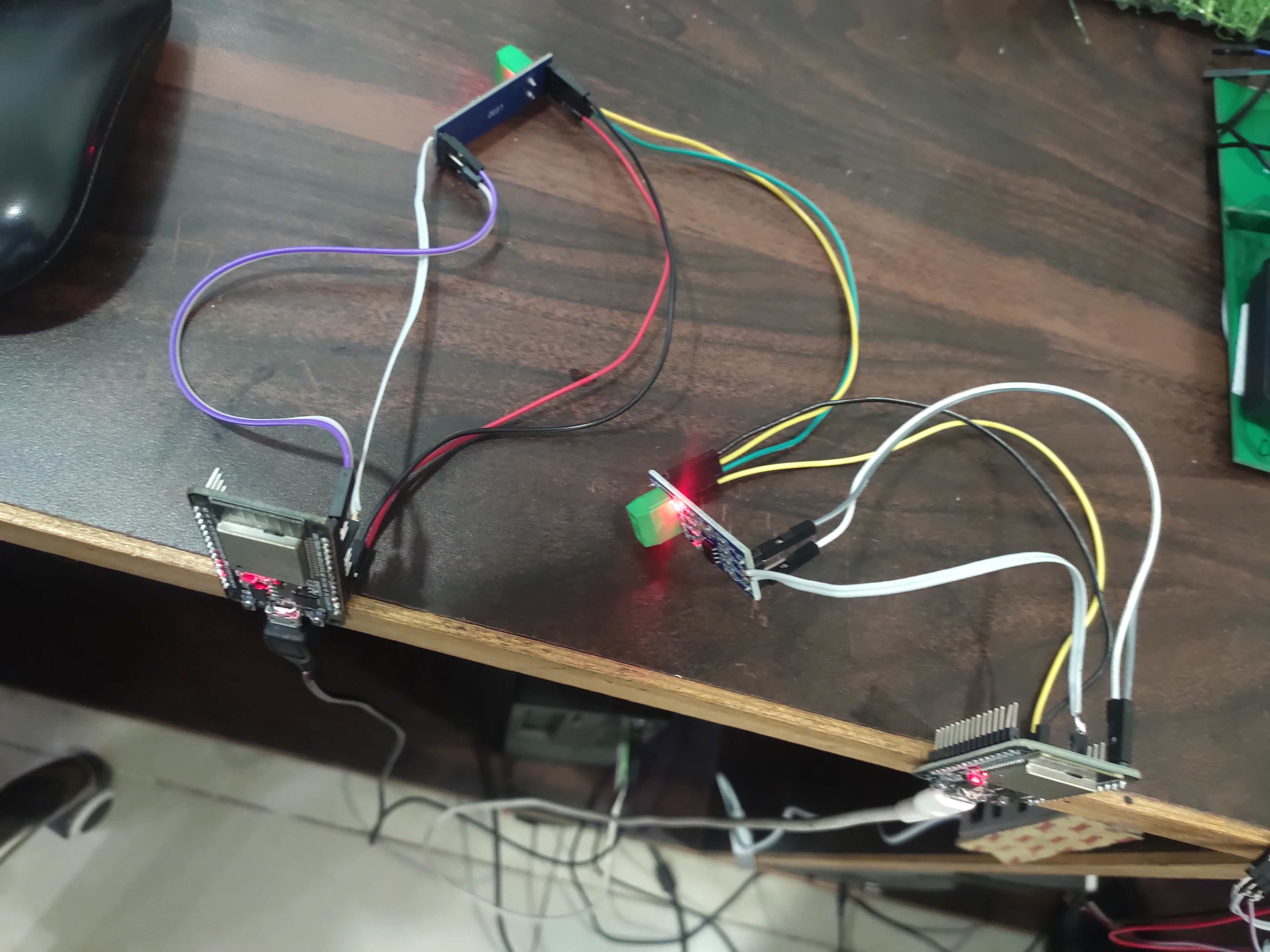

Yes, I have tried the sample code but I want to send slave data to the master
I want to connect the temp and humid sensor to slave( ESP32--->2) and want to get its data to master( ESP32--->1), but I don't know how to configure the GPIO pins in the code to connect the sensor. The code is very complecated.
Please help.
Please help.
- Connection
- processed.jpeg (3.29 MiB) Viewed 14298 times

Here is output of master and slave when tested the default code of master and slave from esp-idf
Master output:
Slave Output:
Why I am not able to read all the data.
Please help.
Master output:
E (20579) MB_CONTROLLER_MASTER: mbc_master_get_parameter(111): SERIAL master get parameter failure error=(0x108) (ESP_ERR_INVALID_RESPONSE).
E (20579) MASTER_TEST: Characteristic #0 (Data_channel_0) read fail, err = 0x108 (ESP_ERR_INVALID_RESPONSE).
E (20599) MB_CONTROLLER_MASTER: mbc_master_get_parameter(111): SERIAL master get parameter failure error=(0x108) (ESP_ERR_INVALID_RESPONSE).
E (20609) MASTER_TEST: Characteristic #1 (Humidity_1) read fail, err = 0x108 (ESP_ERR_INVALID_RESPONSE).
E (20619) MB_CONTROLLER_MASTER: mbc_master_get_parameter(111): SERIAL master get parameter failure error=(0x108) (ESP_ERR_INVALID_RESPONSE).
E (20629) MASTER_TEST: Characteristic #2 (Temperature_1) read fail, err = 0x108 (ESP_ERR_INVALID_RESPONSE).
E (20649) MB_CONTROLLER_MASTER: mbc_master_get_parameter(111): SERIAL master get parameter failure error=(0x108) (ESP_ERR_INVALID_RESPONSE).
E (20649) MASTER_TEST: Characteristic #3 (Humidity_2) read fail, err = 0x108 (ESP_ERR_INVALID_RESPONSE).
E (20669) MB_CONTROLLER_MASTER: mbc_master_get_parameter(111): SERIAL master get parameter failure error=(0x108) (ESP_ERR_INVALID_RESPONSE).
E (20679) MASTER_TEST: Characteristic #4 (Temperature_2) read fail, err = 0x108 (ESP_ERR_INVALID_RESPONSE).
E (20699) MB_CONTROLLER_MASTER: mbc_master_get_parameter(111): SERIAL master get parameter failure error=(0x108) (ESP_ERR_INVALID_RESPONSE).
E (20699) MASTER_TEST: Characteristic #5 (Humidity_3) read fail, err = 0x108 (ESP_ERR_INVALID_RESPONSE).
E (20719) MB_CONTROLLER_MASTER: mbc_master_get_parameter(111): SERIAL master get parameter failure error=(0x108) (ESP_ERR_INVALID_RESPONSE).
E (20729) MASTER_TEST: Characteristic #6 (Test_regs) read fail, err = 0x108 (ESP_ERR_INVALID_RESPONSE).
I (20739) MASTER_TEST: Characteristic #7 RelayP1 (on/off) value = OFF (0x55) read successful.
I (20749) MASTER_TEST: Characteristic #8 RelayP2 (on/off) value = OFF (0xaa) read successful.
E (21249) MASTER_TEST: Alarm is not triggered after 30 retries.
