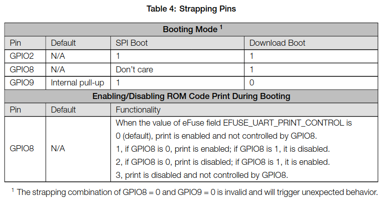

If you take a look at the datasheet, you'll see the strapping pins table (see image):
Screenshot from 2021-08-10 17-05-30.png (59.61 KiB) Viewed 48123 times
This means that both GPIO's 8 and 9 can be used for I2C, since you'll have the pullups required by the I2C. The best to do is to test this on your board and see the results. Probably this gonna work.
The GPIO8 will not make any difference by adding the pullup resistor if you haven't changed the eFuse configuration.
