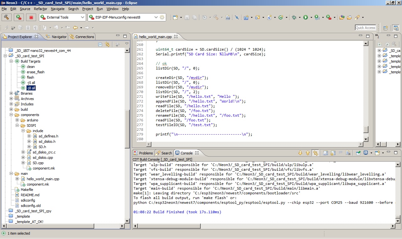

@ESP_igrr wrote, SD SPI driver is almost ready! Hope to release it soon so i think this comes asap in the ESP-IDF.
in the meantime you can sure use the arduino IDE example and it works in arduino ide and also in the esp-idf , example in eclipse without mistake.
have a note how the wire must be done
btw:
cause it is SPI,
you can setup your SPI like you want use your PINS and must then change the wire too on this steps if you want a difference setup.
edit: if you wounder how, check your board example by look up here , then you see example in the ESP32 board (DevKitC board) the used pins for SPI. you can change there - or you can use the SPI.begin with parameters, look example here

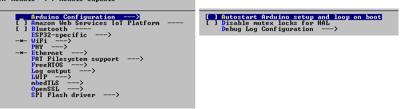

and last but not least:
cause you use the "SD Component" (lib) be sure you have arduino as component in your ESP-IDF path or
took this to the project folder. btw - you can use the SD lib as component too.
edit: ( this solve your problem: "can't find #include "FS.h" #include "SD.h" #include "SPI.h"". )
i change to my project the things little like you see and named it SPISD.
also i sort out header to an include folder.
cause you have then arduino as "component" you can setup in menuconfig what you want to do in the main file
use auto setup() and loop() then you need no main_app
or not - then you need the main_app
