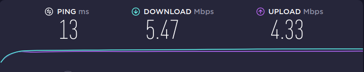

i just tested this example and it works on both, Ubuntu and windows. The problem i found is it is disconnecting from STA very often. Another problem i found is that commands sent from putty do not work, because putty is sending single chars, but example is expecting a command as a 1 buffer.
Here is speedtest with esp32 S2 as RNDIS dongle from this example:
https://github.com/espressif/esp-iot-so ... usb_dongle
