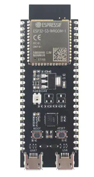

btw:
ESP32-S3-WROOM example on the new ESP32-S3-DEVKITC-1-N8 | ESP32-S3-DEVKITC-1-N8R2
ESP32-S3-DEVKITC-1-N8[R2]

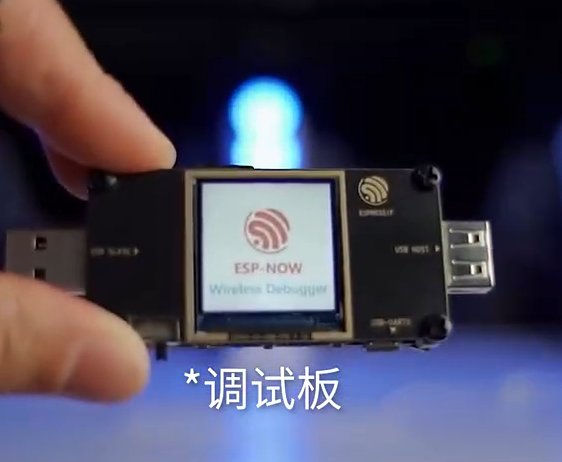

in any case -
modules from the ESP32, ESP32-S3, and ESP32-C3 series will also be included in Espressif's MINI series.
FYI:

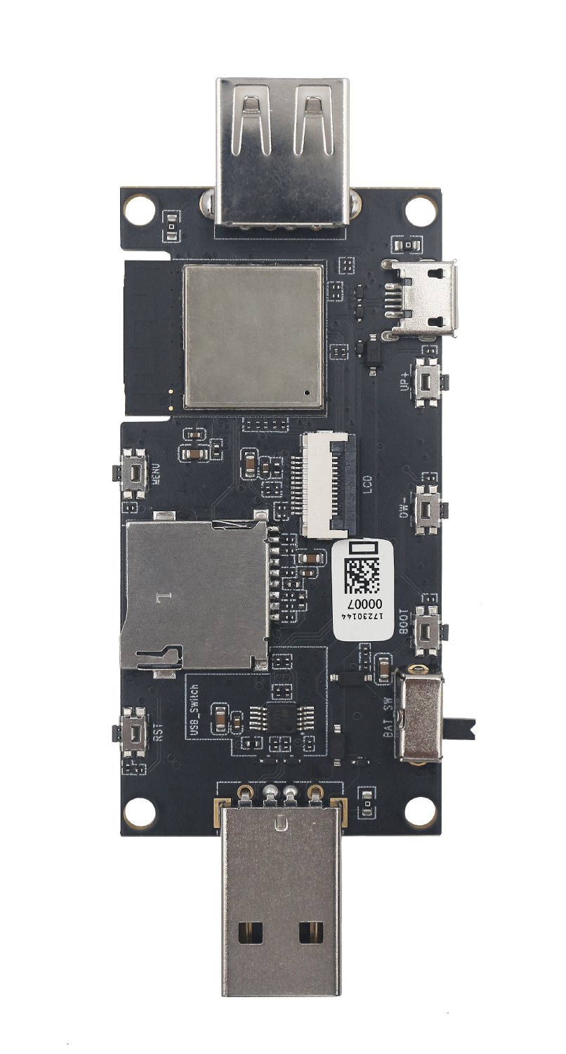

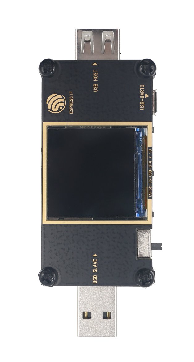

ESP32-S3-USB-OTG with ESP32-S3-MINI is allready available.
i also use Mini Serie's at the Stickley.
Wireless Debug
ESP-NOW
ESP32-S3-USB-OTG
TOP
ESP32-S3-USB-OTG
BACK

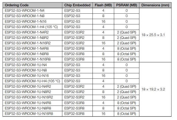

hi mlinaje
you got already replied, I also add my "mustard" :) ..
here are a few additions
in this case to have a certain flash type (H for High Temperature[105°C] or N for Normal [85°C]) and Digit for the size: N8 for 8MB Flash (normal)
in this case to have a certain extra RAM: Digit for the size 2MB, 8MB, 16MB. Note there are Quad SPI and Octal SPI version.
if you have limits in your pcb : note that Octal version needs more IO
ESP32-S3-DevKitC-1-N8 ( normal flash 8 MB )
ESP32-S3-DevKitC-1-N8R2 (normal flash 8 MB and extra psram 2 MB )
ESP32-S3-DevKitC-1-N8R8 (normal flash 8 MB and extra psram 8 MB )
In this case DevKitC is based on WROOM
Note: there is also a DevKitM - this is based on the MINI
Overview:
hope this helps
