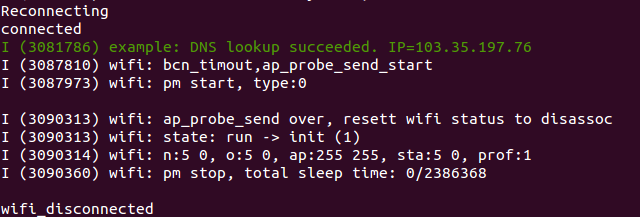

Wifi is getting reset after running continuously showing an error "wifi: bcn_timout,ap_probe_send_start "

I am trying to push some data to sever by http over wifi, but after sending 30-40 minutes it showing the error "wifi: bcn_timout,ap_probe_send_start " , Wifi is disconnecting and trying to connect again, it will connect and show the same error and disconnect. Please help me fix this issue. Please find attachment for error details.

I think what happened here is: wifi beacon frame was sent, this timed out. the esp32 tried to probe the AP, this also failed, which is why you were disconnected
You can expand your event_handler to reconnect if wifi disconnects, also you can move the connect call to the event handler:

I tried the way as you said, changed the event_handler .But still the same issue coming " wifi: bcn_timout,ap_probe_send_start". Please tell any other suggestion you know to fix it.
