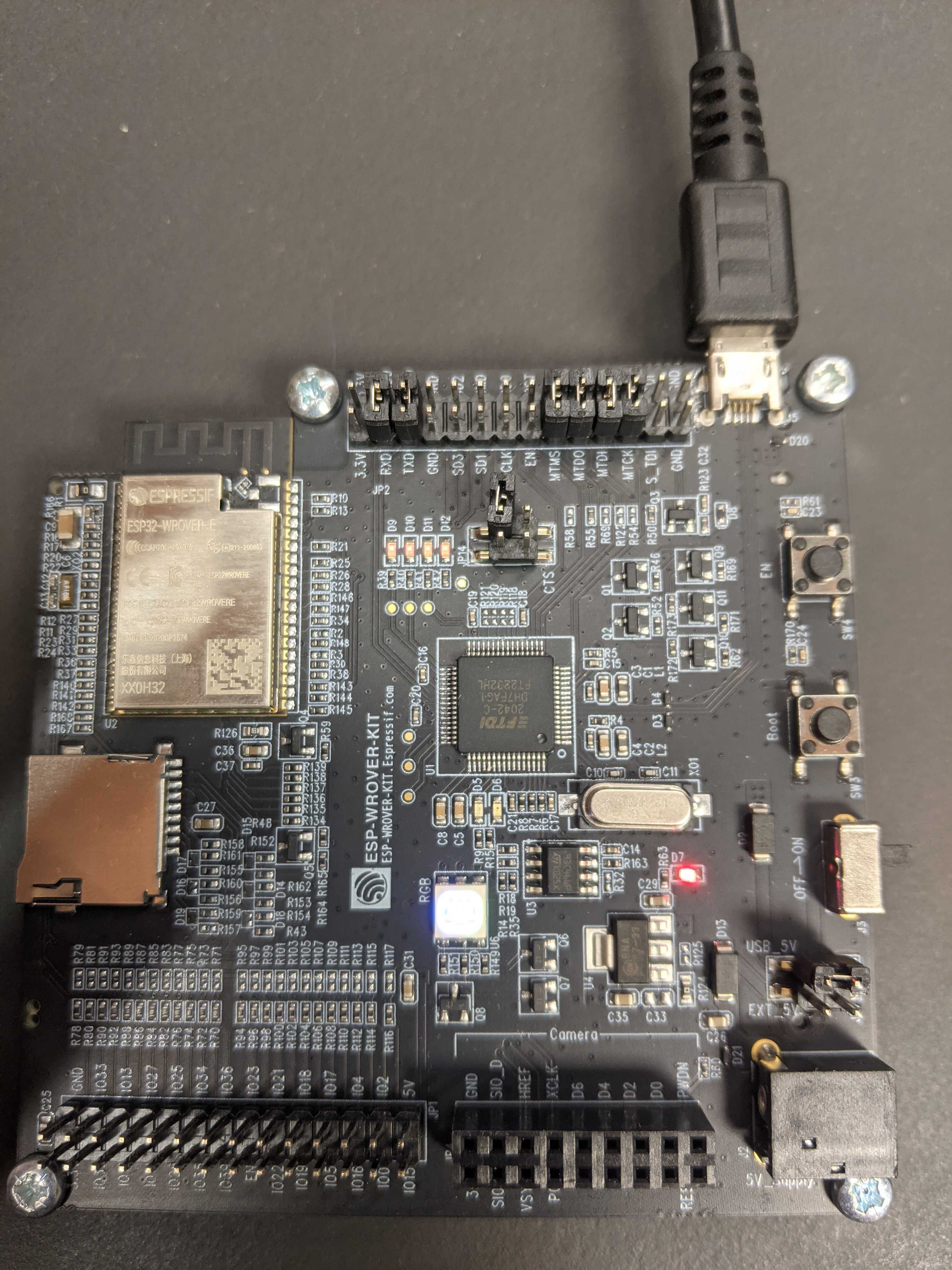

I try to use the JTAG debugger on my ESP-WROVER-KIT-VE in an Arduino and the esp-idf environment with Visual Studio Code and PlatformIO. I wrote a small program to test the debugger:

I set the jumper according to this (https://docs.espressif.com/projects/esp ... r-kit.html) guide to enable JTAG:
JP2:
RXD <-> TXD0
TXD <-> RXD0
MTMS <-> TMS
MTDO <-> TDO
MTDI <-> TDI
MTCK <-> TCK
The board is powered over USB.
I got the following output when PlatformIO starts OpenOCD:
Reading symbols from D:\ESP32-Dev\.pio\build\debug\firmware.elf...
done.
PlatformIO Unified Debugger -> http://bit.ly/pio-debug
PlatformIO: debug_tool = ftdi
PlatformIO: Initializing remote target...
Open On-Chip Debugger  v0.10.0-esp32-20190708 (2019-07-08-11:04)
Licensed under GNU GPL v2
For bug reports, read
none separate
adapter speed: 20000 kHz
Info : Configured 2 cores
esp32 interrupt mask on
Info : tcl server disabled
Info : telnet server disabled
Info : ftdi: if you experience problems at higher adapter clocks, try the command "ftdi_tdo_sample_edge falling"
Info : clock speed 20000 kHz
Error: esp32.cpu0: IR capture error; saw 0x1f not 0x01
Info : accepting 'gdb' connection from pipe
Error: No symbols for FreeRTOS
Error: Target not examined yet
2
Error: Target not halted
Error: auto_probe failed
Error: Connect failed. Consider setting up a gdb-attach event for the target to prepare target for GDB connect, or use 'gdb_memory_map disable'.
Error: attempted 'gdb' connection rejected
Error: error during select: Unknown error
Warn : Flash driver of esp32.flash does not support free_driver_priv()
Warn : Flash driver of irom does not support free_driver_priv()
Warn : Flash driver of drom does not support free_driver_priv()
.pioinit:11: Error in sourced command file:
Remote communication error.  Target disconnected.: Success.
What is wrong here? Why does the Debugger not start?

That error message means that there's an issue between the on-board FT2232H chip we use as a JTAG-to-USB adapter and the ESP32. Are you sure that 1. the jumpers are set exactly like the guide illustrates, and 2. the program you uploaded did succesfully flash? Also, you don't happen to have any other FT2232-based devices connected to your PC?

1) Please take a look at the picture of my board setup
I also try to start the debug mode out of the execution of the application from 1). This result in the following output:
