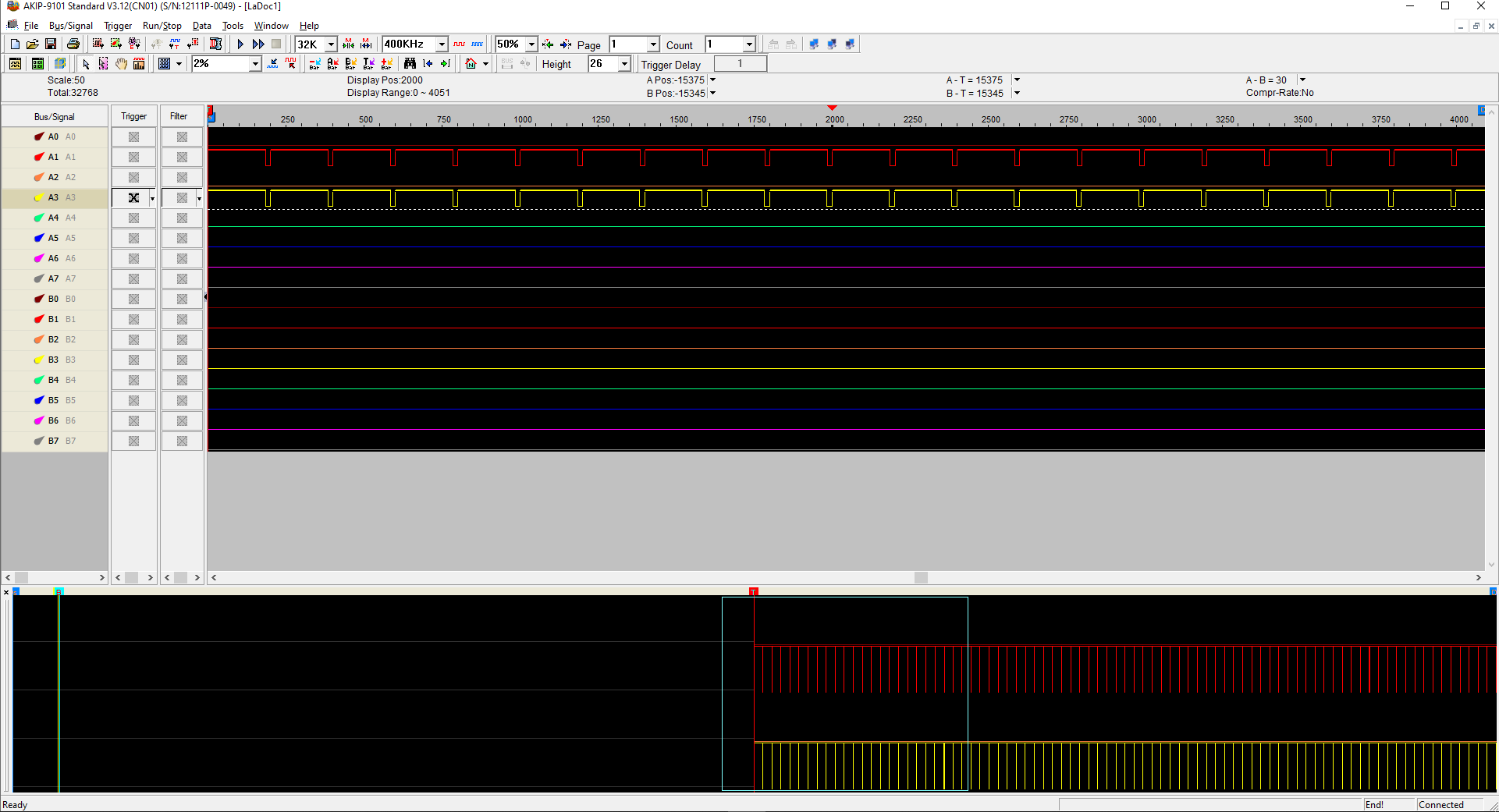

Hi guys!
I try handle external interrupt every 500 us (2000 Hz).
#define USE_GPIO_ISR_SERVICE // sometime skip interrupts when use interrupt service
IRAM_ATTR static void gpio_isr_handler(void* arg)
#ifndef USE_GPIO_ISR_SERVICE
	uint32_t gpio_intr_status = READ_PERI_REG(GPIO_STATUS_REG);   //read status to get interrupt status for GPIO0-31
	uint32_t gpio_intr_status_h = READ_PERI_REG(GPIO_STATUS1_REG);//read status1 to get interrupt status for GPIO32-39
	SET_PERI_REG_MASK(GPIO_STATUS_W1TC_REG, gpio_intr_status);    //Clear intr for gpio0-gpio31
	SET_PERI_REG_MASK(GPIO_STATUS1_W1TC_REG, gpio_intr_status_h); //Clear intr for gpio32-39
#endif
	//myCode
	BaseType_t mustYield = pdFALSE;
	vTaskNotifyGiveFromISR(my_task_handle, &mustYield);
	if (mustYield)
		portYIELD_FROM_ISR();
void init(void) {
	esp_err_t ret = ESP_OK;
	gpio_config_t io_conf;
	//interrupt of rising edge
	io_conf.intr_type = GPIO_INTR_NEGEDGE;
	io_conf.pin_bit_mask = ((uint64_t)1 << ADC_PIN_nDR);
	io_conf.mode = GPIO_MODE_INPUT;
	io_conf.pull_down_en = 0;
	io_conf.pull_up_en = 0;
	ret |= gpio_config(&io_conf);
	xTaskCreate(dsp_task, "my_task", 4096, NULL, MY_TASK_PRIO, &my_task_handle);
#ifdef USE_GPIO_ISR_SERVICE
	ret |= gpio_install_isr_service(ESP_INTR_FLAG_IRAM);
	gpio_isr_handler_add(ADC_PIN_nDR, gpio_isr_handler, (void*)ADC_PIN_nDR);
#else
	gpio_intr_enable(ADC_PIN_nDR);
	gpio_set_intr_type(ADC_PIN_nDR, GPIO_INTR_NEGEDGE);
	gpio_isr_register(gpio_isr_handler, NULL, ESP_INTR_FLAG_IRAM, NULL);
#endif
Sometime ouccur interrupt skips when using gpio_install_isr_service(). IMORTANT: without hi loaded my_task wake up with vTaskNotifyGiveFromISR() interrupt skips not occur.
When use alternate API gpio_isr_register() interrupt skips not occur.
Why ESP32 not properly handle external interrupts with gpio_install_isr_service()?

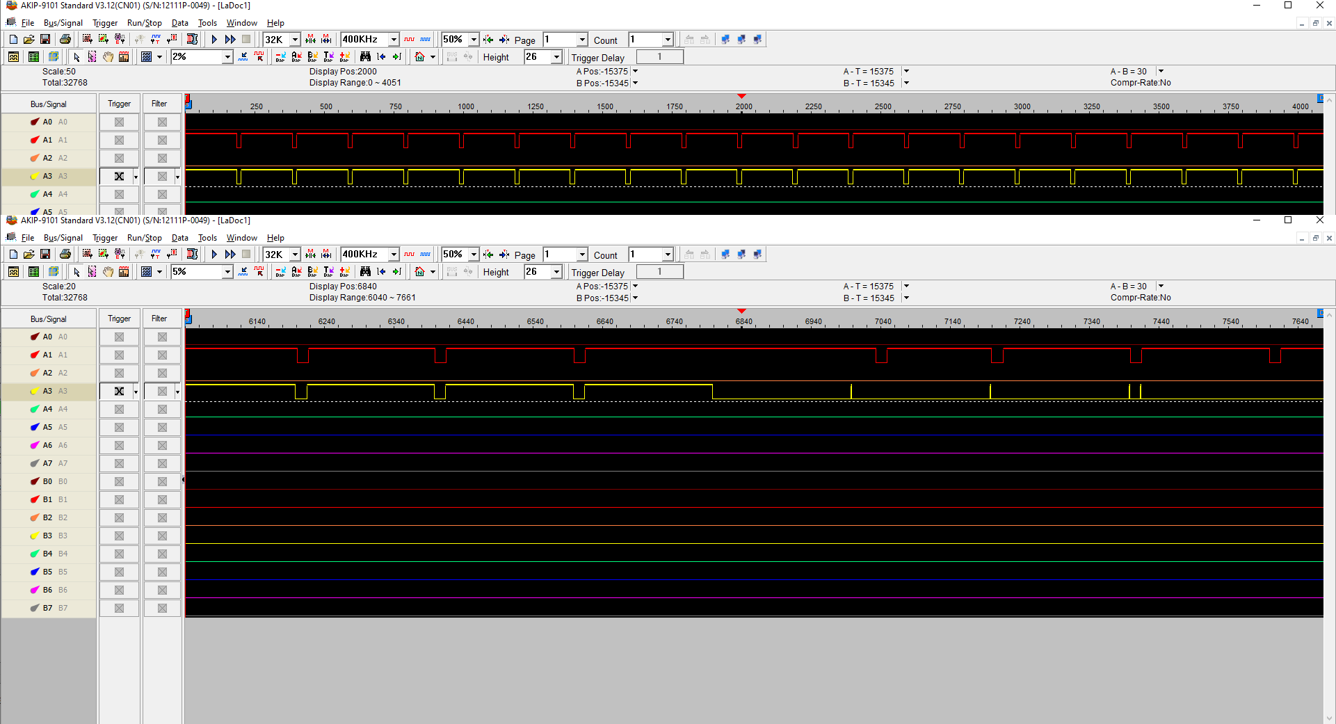

I just ran into the same issue as well, just like moggiozzi. I too had two external interrupts wired into GPIO pins, both running at moderate speeds, configured with gpio_install_isr_service()/gpio_isr_handler_add(). However, I set up test pin outputs with an oscilloscope and I was able to catch instances where some interrupts would completely be missed (not defered!) if they were happening at about the same time. I wondered about configuring my own, catch-all ISR via gpio_isr_register() instead, and then I saw this post. Low and behold, I was able to resolve the issue by doing exactly this.
I am using ESP-IDF V5.4, which is the stable version for this date. Obviously, those who are responsible for the IDF have not yet fixed this issue with gpio_install_isr_service() and gpio_isr_handler_add(). Beware.
UPDATE: My fix to write my own, common GPIO ISR for my two h/w interrupts did improve things by reducing the number of missed interrupts, but it was not 100%. After doing more research into this issue, I now see that it is a hardware race issue with the ESP32, not a firmware issue. That is really disheartening. Since the collisions seem to be happening when GPIO_STATUS_W1TC_REG is written to clear an ISR bit (by the ESP-IDF or any hand-crafted firmware) while another interrupt is coming in simultaneously updating another bit in the GPIO_STATUS_REG (perhaps via GPIO_STATUS_W1TS_REG or some other hardware), it is possible that if I move one of my h/w ISR connections to a pin on the other GPIO bank (i.e. GPIO_STATUS1_REG for GPIO 32-39), it might resolve the issue. I only have two critical h/w interrupts, so I'll give this change a try.
