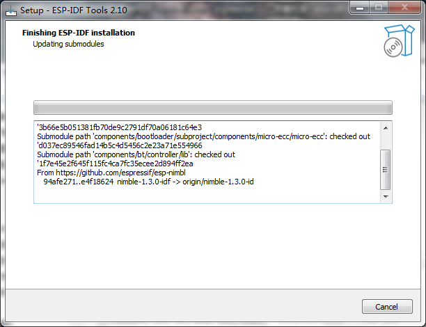

新建了一个文件夹,使用esp-idf-tools-setup-offline-2.10离线安装器安装,到最后一步出现以下问题
Installation process succeeded.
2021-11-04 14:48:42.376 Extracting temporary file: C:\Users\lw\AppData\Local\Temp\is-BL8J7.tmp\7za.exe
2021-11-04 14:48:42.440 Executing: C:\Users\lw\AppData\Local\Temp\is-BL8J7.tmp\idf-env.exe driver install --ftdi --silabs --espressif
2021-11-04 14:49:28.304 Result: Downloading https://www.silabs.com/documents/public ... Driver.zip to cp210x.zip
Downloading https://www.ftdichip.com/Drivers/CDM/CD ... tified.zip to ftdi.zip
Downloading https://dl.espressif.com/dl/idf-driver/ ... -07-15.zip to idf-driver-esp32-usb-jtag-2021-07-15.zip
Installing driver with INF D:\ESP32\.espressif\tools\idf-driver\silabs-2021-05-03\silabser.inf -> C:\Windows\INF\oem44.inf ... Ok
Installing driver with INF D:\ESP32\.espressif\tools\idf-driver\ftdi-2021-05-03\ftdiport.inf -> C:\Windows\INF\oem45.inf ... Ok
Installing driver with INF D:\ESP32\.espressif\tools\idf-driver\idf-driver-esp32-usb-jtag-2021-07-15\usb_jtag_debug_unit.inf -> C:\Windows\INF\oem46.inf ... Ok
2021-11-04 14:49:28.304 Setting PATH for this process: D:\ESP32\.espressif\tools\idf-python\3.8.7\;D:\ESP32\.espressif\tools\idf-git\2.30.1\cmd\;C:\Program Files\Common Files\Oracle\Java\javapath;C:\Windows\system32;C:\Windows;C:\Windows\System32\Wbem;C:\Windows\System32\WindowsPowerShell\v1.0\;C:\Program Files (x86)\NVIDIA Corporation\PhysX\Common;C:\Program Files (x86)\Common Files\NSEC\;E:\Git\Git\cmd;C:\Program Files\TortoiseGit\bin;E:\InstallSoftware\GitServer\nssm-2.24\win64;;E:\VSCode\Microsoft VS Code\bin;C:\Users\lw\AppData\Local\Programs\Python\Python37;C:\Program Files (x86)\MyDrivers\DriverGenius;C:\Program Files (x86)\MyDrivers\DriverGenius\ksoft
2021-11-04 14:49:28.304 PYTHONNOUSERSITE=True
2021-11-04 14:49:28.304 PYTHONPATH=
2021-11-04 14:49:28.304 PYTHONHOME=
2021-11-04 14:49:28.304 IDFTempPath - location of bundle: D:\ESP32\.espressif\releases\esp-idf-bundle
2021-11-04 14:49:28.304 Updating submodules: D:\ESP32\.espressif\tools\idf-git\2.30.1\cmd\git.exe -C D:\ESP32\esp-idf-v4.2.2 checkout v4.2.2
2021-11-04 14:49:36.360 Done, exit code=0
2021-11-04 14:49:36.360 --------
2021-11-04 14:49:36.360 Running command: D:\ESP32\.espressif\tools\idf-git\2.30.1\cmd\git.exe -C D:\ESP32\esp-idf-v4.2.2 checkout v4.2.2
warning: unable to rmdir 'components/bt/controller/lib_esp32': Directory not empt
warning: unable to rmdir 'components/bt/controller/lib_esp32c3_family': Directory not empt
warning: unable to rmdir 'components/cmock/CMock': Directory not empt
Previous HEAD position was c9646ff0b versions: Update version to 4.3.
HEAD is now at 7ab8f793c versions: Update version to 4.2.
2021-11-04 14:49:36.368 Updating submodules: D:\ESP32\.espressif\tools\idf-git\2.30.1\cmd\git.exe -C D:\ESP32\esp-idf-v4.2.2 submodule update --init --recursive
2021-11-04 14:50:27.321 Done, exit code=1
2021-11-04 14:50:27.321 --------
2021-11-04 14:50:27.321 Running command: D:\ESP32\.espressif\tools\idf-git\2.30.1\cmd\git.exe -C D:\ESP32\esp-idf-v4.2.2 submodule update --init --recursive
Submodule path 'components/asio/asio': checked out '3b66e5b051381fb70de9c2791df70a06181c64e3
Submodule path 'components/bootloader/subproject/components/micro-ecc/micro-ecc': checked out 'd037ec89546fad14b5c4d5456c2e23a71e554966
Submodule path 'components/bt/controller/lib': checked out '1f7e45e2f645f115fc4ca7fc35ecee2d894ff2ea
From https://github.com/espressif/esp-nimbl
94afe271..e4f18624 nimble-1.3.0-idf -> origin/nimble-1.3.0-id
fatal: unable to access 'https://github.com/espressif/esp-nimble.git/': OpenSSL SSL_read: Connection was reset, errno 1005
Fetched in submodule path 'components/bt/host/nimble/nimble', but it did not contain 57d751b93a5532e650ec3787d376876ab0ce367e. Direct fetching of that commit failed
2021-11-04 14:50:27.321 Message box (OK):
Installation has failed with exit code 1
2021-11-04 14:50:43.791 User chose OK.
2021-11-04 14:50:43.798 Message box (Yes/No):
Installation log has been created, it may contain more information about the problem.
Display the installation log now?
2021-11-04 14:50:45.250 User chose Yes.
2021-11-04 14:50:45.325 CurStepChanged raised an exception.

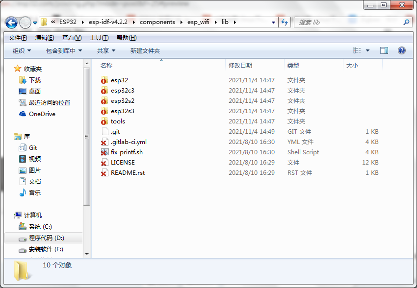

此时安装路径下已经出现了刚才安装的4.2.2版本的工具链。但是其中D:\ESP32\esp-idf-v4.2.2\components路径下有很多子模块没有更新成功文件图标有红色感叹号或红叉(下面有截图附件)。
然后拷贝工具链例程中blufi例程出来,使用VScode打开:打开终端,进入到esp-idf-v4.2.2路径下,运行install.bat ,成功后又运行export.bat也成功。此时已出现
Done! You can now compile ESP-IDF projects.
Go to the project directory and run:
idf.py build
然后编译 idf.py build,能编译一些:[337/1198] Building C object esp-idf/lwip/CMakeFiles/__idf_lwip.dir/lwip/src/core/pbuf.c.obj
就这样一直编译,直到出现以下错误:
D:\ESP32\blufi>idf.py build
Executing action: all (aliases: build)
Running ninja in directory d:\esp32\blufi\build
Executing "ninja all"...
[1/586] Performing build step for 'bootloader'
ninja: no work to do.
[2/584] Generating x509_crt_bundle
FAILED: esp-idf/mbedtls/x509_crt_bundle
cmd.exe /C "cd /D D:\ESP32\blufi\build\esp-idf\mbedtls && D:\ESP32\.espressif\python_env\idf4.2_py3.7_env\Scripts\python.exe D:/ESP32/esp-idf-v4.2.2/components/mbedtls/esp_crt_bundle/gen_crt_bundle.py --input D:/ESP32/esp-idf-v4.2.2/components/mbedtls/esp_crt_bundle/cacrt_all.pem -q"
gen_crt_bundle.py: Invalid certificate in D:/ESP32/esp-idf-v4.2.2/components/mbedtls/esp_crt_bundle/cacrt_all.pem
Invalid certificate
ninja failed with exit code 1
至此编译失败

到此原本打算从4.2版本更新到4.2.2就彻底失败了。这个问题花了我两天时间。期间试过各种问题,网络有问题的也试过从gitee上克隆,但发现gitee上子模块已经很久没更新了。也试过直接从github上下载压缩包后解压替换。但最终都回到子模块更新失败上面。
在尝试的过程中发现idf.py build编译有时候会编译完成,但到了链接的时候就说少文件,提示的路径也在子模块里。
至此已完全没了头绪,遂来论坛找各位帮忙,希望有解决思路的能提供一些详细帮助。

- 子模块更新没成功.png (103.21 KiB) Viewed 7500 times
- 安装错误.png (68.31 KiB) Viewed 7500 times

其实原因归根到底是我离线安装时idf是安装完成了但是子模块没有拉取成功。
解决方法就是去里面找到对应版本,然后在Download an archive with submodules included下面点那个链接下载已经配置完所有子模块的压缩包,这个下载就很快。网上那些杂七杂八的对github上下载优化的对esp-idf拉子模块都是扯淡。直接下载官方配置好的压缩包解压覆盖他不香吗?
