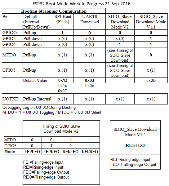

Hi everyone,
Espressif can you check if the ESP32 Boot Mode is correct ? (it is extracted from different document / source code)
Sources:
  • esp32-devkitc_getting_started_guide_en.pdf
  • esp_wroom_32_datasheet_en.pdf => Table 4: Strapping Pins
  • esp32_datasheet_en_0-1.pdf => §2.4 Strapping Pins
Any feedback is welcome especially for SDIO Slave Download Mode V2 & SDIO Slave Download Mode V1.1
If you have more details on those mode it will be great too

I think this information is available from ESP32 Pin List document:
http://espressif.com/sites/default/file ... ist_en.pdf
