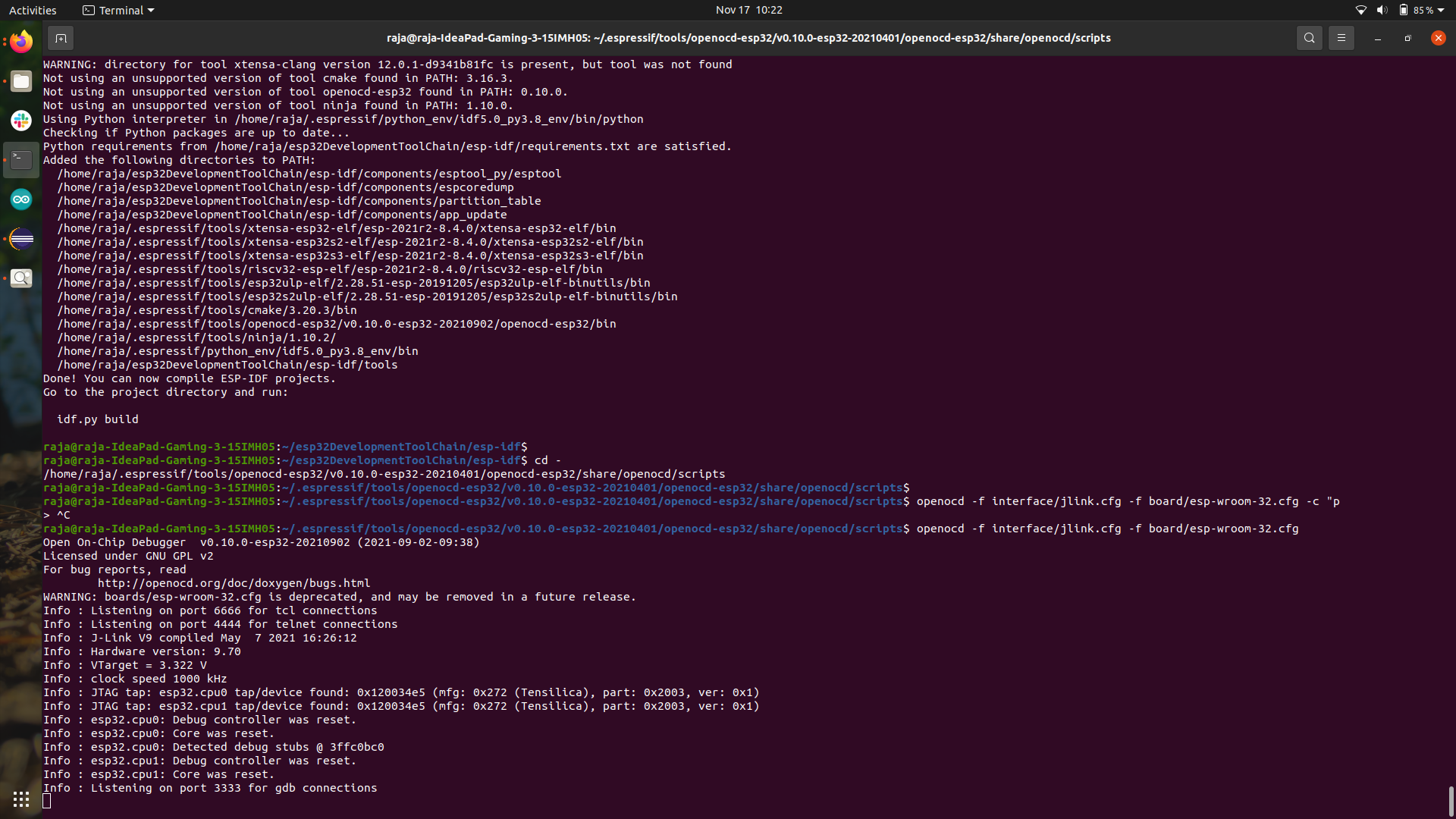

When I ran openocd, I got the following error.
raja@raja-IdeaPad-Gaming-3-15IMH05:~/esp32DevelopmentToolChain/esp-idf/projects/EnergyMeter$ openocd -s tcl -f interface/jlink.cfg -f board/esp-wroom-32.cfg
Open On-Chip Debugger  v0.10.0-esp32-20210902 (2021-09-02-09:38)
Licensed under GNU GPL v2
For bug reports, read
WARNING: boards/esp-wroom-32.cfg is deprecated, and may be removed in a future release.
Info : J-Link V9 compiled May  7 2021 16:26:12
Info : Hardware version: 9.70
Info : VTarget = 3.316 V
Error: JTAG I/O operation failed: 0x1.
Error: jaylink_jtag_io() failed: device: unspecified error.
Error: An adapter speed is not selected in the init script. Insert a call to adapter_khz or jtag_rclk to proceed.
openocd: ../src/jtag/core.c:343: jtag_checks: Assertion `jtag_trst == 0' failed.
Aborted (core dumped)
I am trying to get the JTAG connected for debugging.

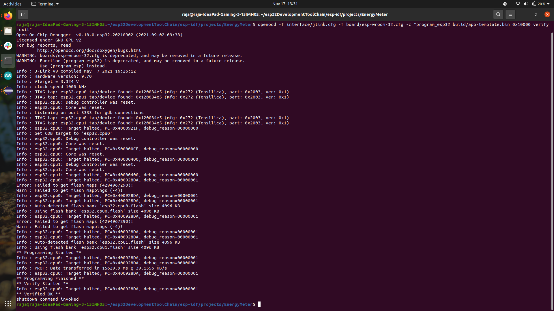

I was able to connect the jlink with openocd command and flash it but I am unable to launch the gui debug.
Flash:
Screenshot from 2021-11-17 13-31-25.png (392.95 KiB) Viewed 7535 times
Please suggest if the program got flashed as expected.
Connect openocd:
Screenshot from 2021-11-17 10-22-52.png (371.61 KiB) Viewed 7535 times
However, I am unable to open the gui mode using both idf.py or openocd or through eclipse.

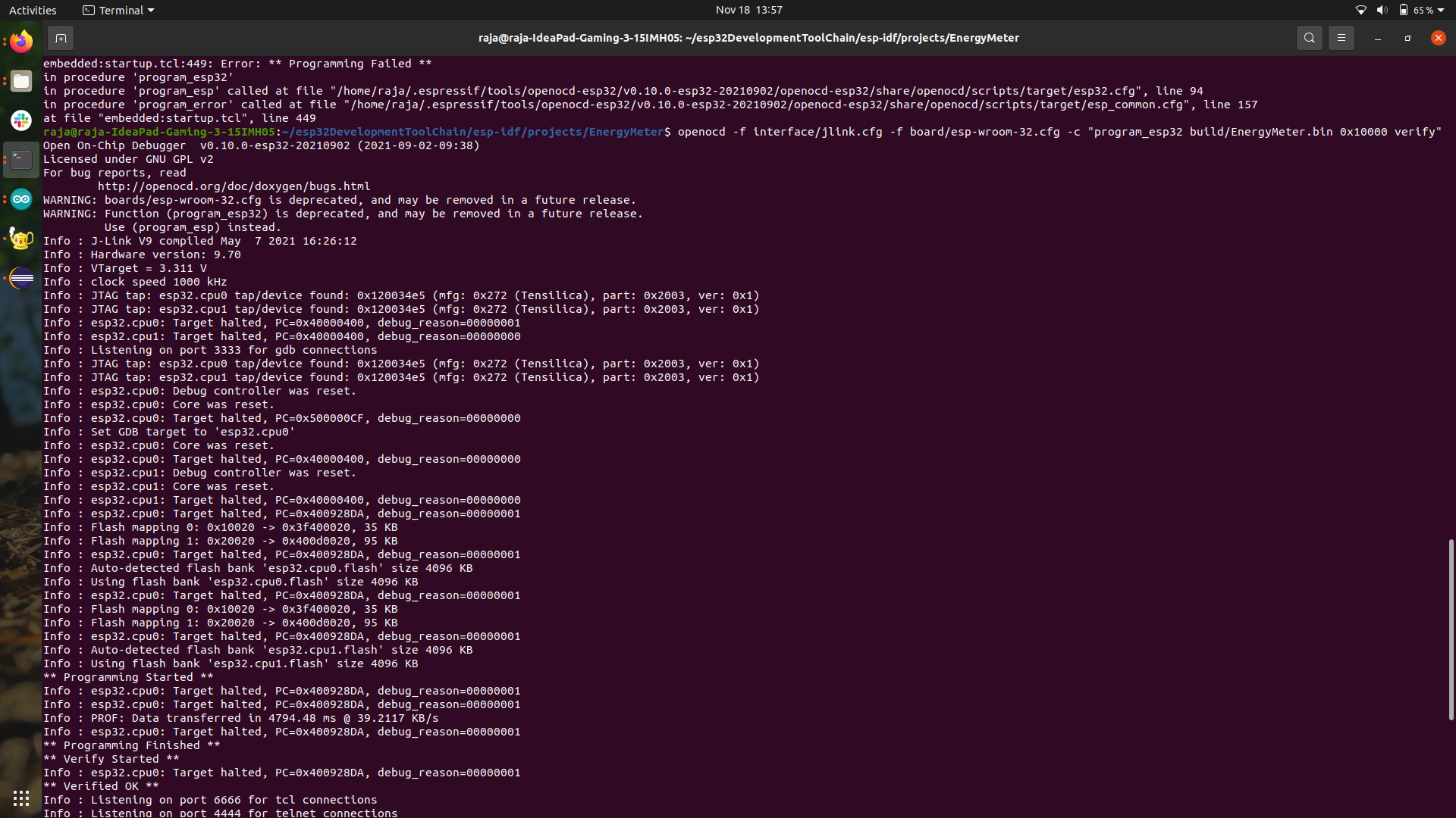

I fixed the issue by following the below steps:
Firstly, I changed the adapter frequency to 1 KHz
Secondly, I started the openocd server by flashing the code to it and not having exit statement
raja@raja-IdeaPad-Gaming-3-15IMH05:~/esp32DevelopmentToolChain/esp-idf/projects/EnergyMeter$ openocd -f interface/jlink.cfg -f board/esp-wroom-32.cfg -c "program_esp32 build/EnergyMeter.bin 0x10000 verify"Open On-Chip Debugger  v0.10.0-esp32-20210902 (2021-09-02-09:38)
WARNING: Function (program_esp32) is deprecated, and may be removed in a future release.
         Use (program_esp) instead.
Info : VTarget = 3.311 V
Info : clock speed 1000 kHz
Info : esp32.cpu0: Target halted, PC=0x40000400, debug_reason=00000001
Info : esp32.cpu1: Target halted, PC=0x40000400, debug_reason=00000000
Info : esp32.cpu0: Debug controller was reset.
Info : esp32.cpu0: Core was reset.
Info : esp32.cpu0: Target halted, PC=0x500000CF, debug_reason=00000000
Info : Set GDB target to 'esp32.cpu0'
Info : esp32.cpu0: Target halted, PC=0x40000400, debug_reason=00000000
Info : esp32.cpu1: Debug controller was reset.
Info : esp32.cpu1: Core was reset.
Info : esp32.cpu0: Target halted, PC=0x400928DA, debug_reason=00000001
Info : Flash mapping 0: 0x10020 -> 0x3f400020, 35 KB
Info : Flash mapping 1: 0x20020 -> 0x400d0020, 95 KB
Info : Auto-detected flash bank 'esp32.cpu0.flash' size 4096 KB
Info : Using flash bank 'esp32.cpu0.flash' size 4096 KB
Info : Auto-detected flash bank 'esp32.cpu1.flash' size 4096 KB
Info : Using flash bank 'esp32.cpu1.flash' size 4096 KB
** Programming Started **
Info : PROF: Data transferred in 4794.48 ms @ 39.2117 KB/s
** Programming Finished **
** Verify Started **
** Verified OK **
Info : Using flash bank 'esp32.cpu0.irom' size 96 KB
Info : Using flash bank 'esp32.cpu0.drom' size 36 KB
Info : New GDB Connection: 1, Target esp32.cpu0, state: halted
Warn : negative reply, retrying
Error: Too large number of threads 3261657114!
Info : esp32.cpu0: Target halted, PC=0x400D8C5F, debug_reason=00000001
Info : esp32.cpu1: Target halted, PC=0x4000C050, debug_reason=00000000
It is to be noted that having exit in the flash command -c "program_esp32 .... verify exit" will flash the the chip but will exit the telnet!
It has to be avoided if you want to start a gdb session.

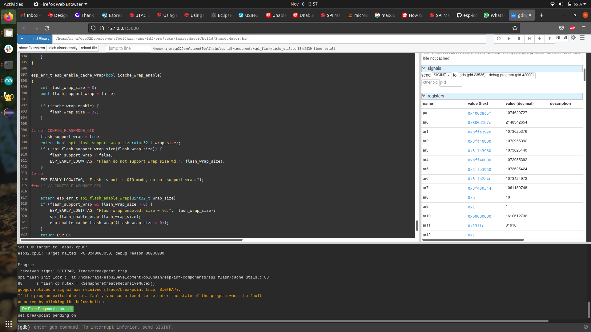

Thirdly, I started the gdbgui by
idf.py gdbgui
Screenshot from 2021-11-18 13-57-36.png (398.79 KiB) Viewed 7462 times
This worked like a charm.
I hope to replicate the same in eclipse configuration. I think I will succeed.
