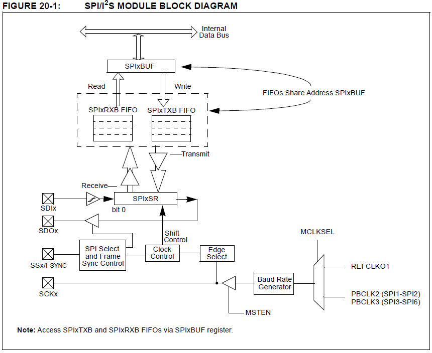

Hi @ESP_Sprite,
How i can send command + parameters(before send pixels) to the lcd in the hw_lcd peripheral ?
Does hw_lcd peripheral have fifo buffer ?
If yes ? What size ? Example: 32 positions with 32 bits each position.
I can set this position size ? If yes. Works in dma mode and not dma mode ?
How to know if the hw_lcd peripheral fifo tx are full ?
How to know how many fifo places are full or are empty ?
Can i read some empty places tx fifo counter ?
Or, can i read some full places fifo tx counter ?
Example: 32 fifo positions. 10 filled and 22 empty.
Microchip example: TXBUFELM<4:0>: Transmit Buffer Element Count bits (valid only when ENHBUF = 1).
i want to do something like this:
Microchip datasheet:
SPITBF: SPI Transmit Buffer Full Status bit
1 = Transmit not yet started, SPITXB is full
0 = Transmit buffer is not full
Standard Buffer Mode:
Automatically set in hardware when the core writes to the SPIBUF location, loading SPITXB.
Automatically cleared in hardware when the SPI module transfers data from SPITXB to SPISR.
Enhanced Buffer Mode:
Set when CWPTR + 1 = SRPTR; cleared otherwise
while( SPI1STATbits.TXBUFELM > 4 );
SPI1BUF = 0b1111111111000000;
- fifo_example.png (38.35 KiB) Viewed 143343 times
