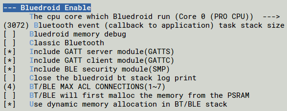

First of all, thank you Boris for your fantastic work.
I have a question regarding bluetooth and the inclusion of header files associated with it. I have enabled Bluetooth and Bluedroid support in the Kconfig system.
I get the error
fatal error: esp_bt.h: No such file or directory
when trying to include the header file "esp_bt.h" with the include command
#include "esp_bt.h"
When including other header files, like "freertos/task.h" it works fine.
What could I do to resolve or troubleshoot this error?
