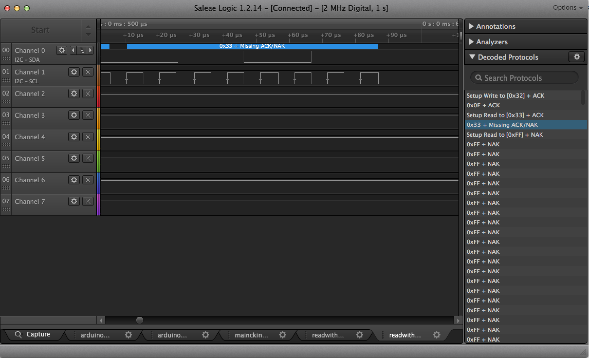

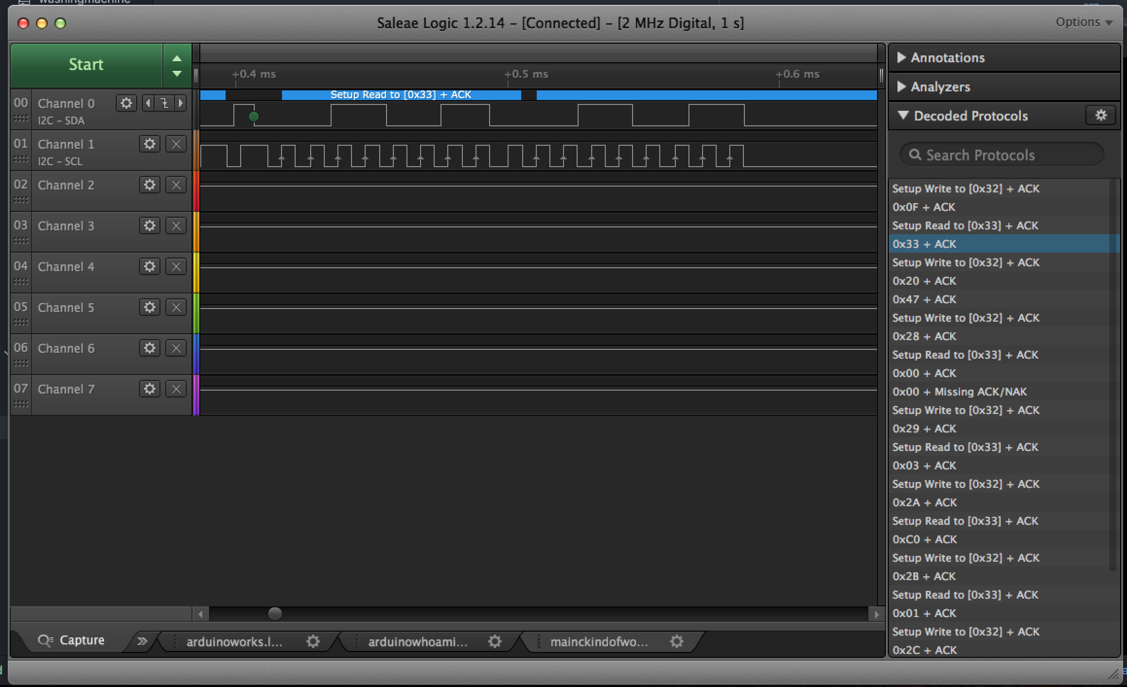

As far as I understand this is the correct way to read a single byte from the I2C bus. However it fails to return successfully. If I switch the NACK_VAL to an ACK_VAL however (which is incorrect because we only want to read a single byte), it does successfully read the value. Debugging with a logic analyser, we can see a little bit what is going on. It appears that when I ask the driver to read a byte with a NACK bit, the SCL clock simply stops.
Not working with NACK:
Kind of working but not really with ACK:
I have no idea why this is happening but it is very reliable. Also, the original Arduino version is able to send a NACK bit with no problems and the SCL clock continues to run smoothly. Any ideas what I am doing wrong or what I might try next to continue debugging?

You aren't using any i2c_master_stop commands?

Postby spuzesp32 » Thu Jul 27, 2017 8:30 am
Thank you WiFive, that is exactly what was wrong! I feel stupid that it was such a simple error but also glad it wasn't something more nasty. :D
